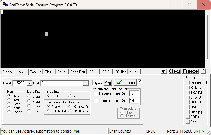

I'm writing a UART driver for NUCLEO-F103RB and I followed all steps in the book "Bare-metal embedded C programming" and advices from Gemini but still can't see the receiving output from my PC.
How can I fix this?
Other parts than UART work without problem in this setting.

@Jajang01 wrote:NUCLEO-F103RB
So, presumably, you are using the ST-Link's VCP (Virtual COM Port) to connect to the PC ?
Are you sure that you are using the correct UART pins for that ?
Have you tried one of the ST examples for reference?

2025-11-26 1:13 PM
Yes, it shows up in the device manager and the user manual says the USART2 communication between the target STM32 and ST-LINK MCU is enabled, to support virtual COM port by default

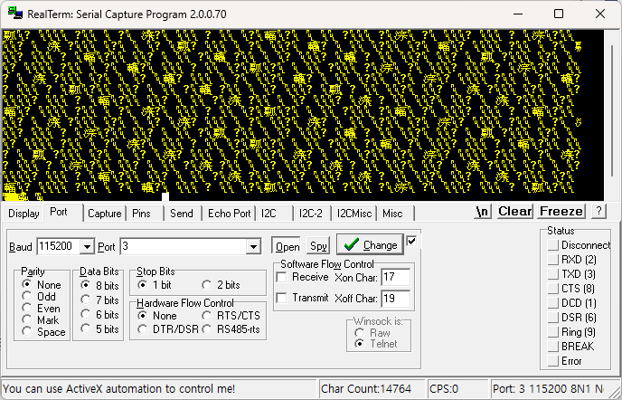

2025-11-27 12:01 AM
I changed the code using the baud rate calculation from HAL but it transmits weird things

UART baud rates are standardized.
Take a scope (or logic analyser), and measure the actual bit length.
The best way to do this is to repeatedly transmit a 0x55 or 0xAA character.
And check the waveform of single character transmissions.
I would do that at 9600bps instead of 115200, but this is personal preference.

@Jajang01 wrote:I changed the code using the baud rate calculation from HAL but it transmits weird things
At least that shows that you are using the correct pins!
Garbage characters shows that your baud rate is wrong.
Again (as @TDK also said), use the supplied ST examples for reference...
2025-11-27 1:01 AM
At least you get something.
Probably baud rate still not correct.
What TDK meant:
