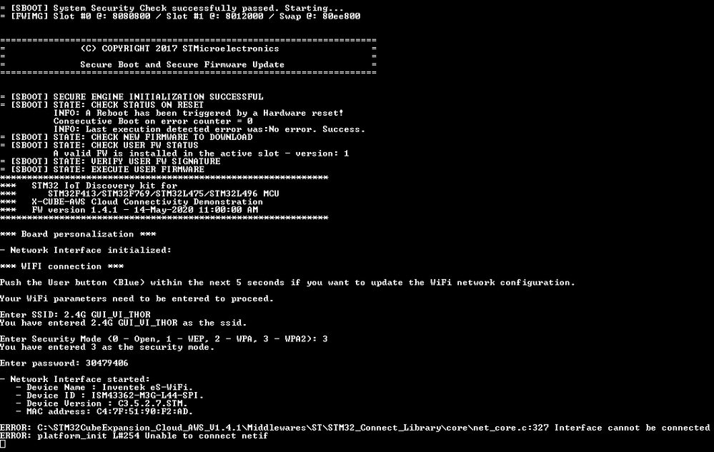

I'm trying to run the Getting Started firmware for the B-L475E-IOT01A board but I'm having problems to connect to WiFi. The error messages are:
"ERROR: C:\STM32CubeExpansion_Cloud_AWS_V1.4.1\Middlewares\ST\STM32_Connect_Library\core\net_core.c:327 Interface cannot be connected
ERROR: platform_init L#254 Unable to connect netif"

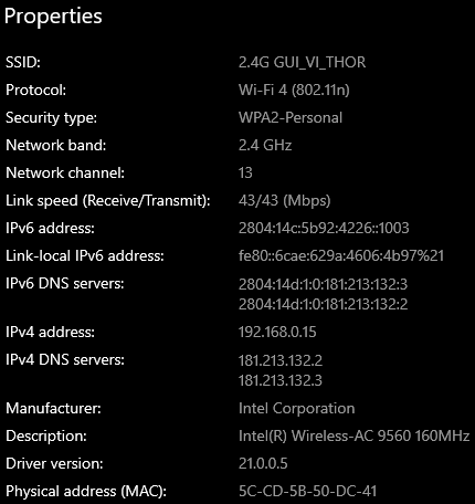

These are my WiFi Properties:

- I'm using the following Getting Started firmware: STM32CubeExpansion_Cloud_AWS_V1.4.1\Projects\B-L475E-IOT01A\Applications\Cloud\AWS\Binary\SBSFU_B-L475E-IOT01_Cloud_AWS_V1.4.1.bin
- The target board is the B-L475E-IOT01A2
Am I missing something?

Hello @gvamorim​ and welcome to the Community :)
Did you try the WiFi project for B-L475E-IOT01A board available within STM32CubeL4 MCU package?
- https://github.com/STMicroelectronics/STM32CubeL4/tree/master/Projects/B-L475E-IOT01A/Applications/WiFi
- \Repository\STM32Cube_FW_L4_V1.17.1\Projects\B-L475E-IOT01A\Applications\WiFi\
Imen

‎2022-10-24 5:39 AM
hello.
- are you using an iPhone as WiFi/4G gateway to connect the B-L475E-IOT01 to WiFi ? with a recent version of iOS ? it may require WPA3 which B-L475E-IOT01 WiFi module doesn't support.
- other possibility (maybe): try to configure the SSID name of your WiFi access point without a space character in the SSID name
‎2022-10-24 8:45 PM
Hi @Guillaume K​ and @Imen DAHMEN​ ,
I'm now able to connect to the WiFi access point. It seems that the WiFi should be configured with access point and I was not aware of that.
