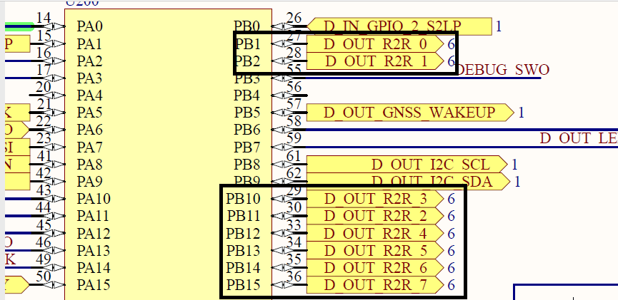

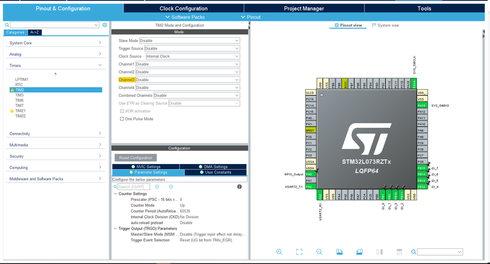

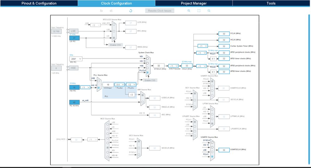

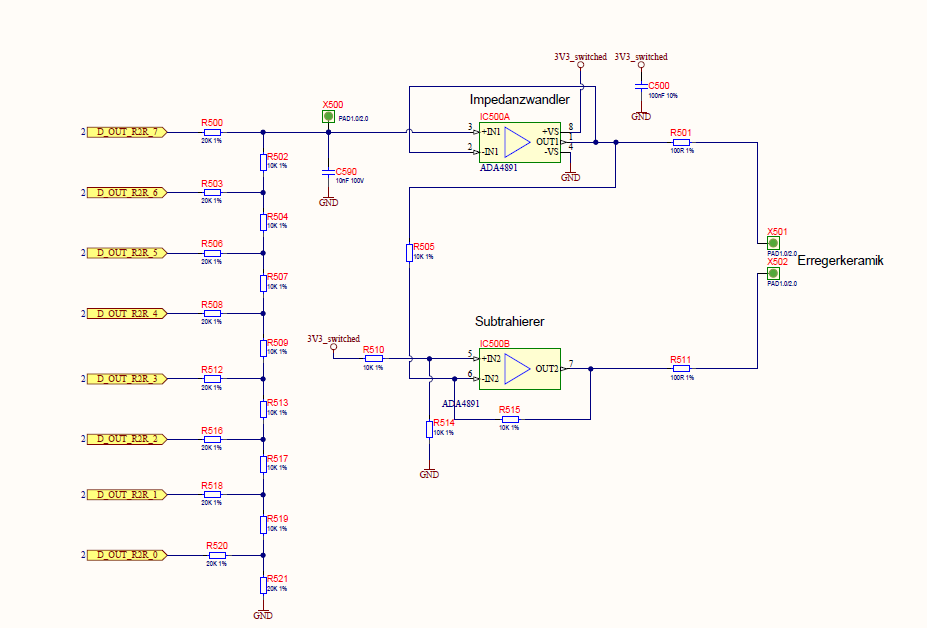

This are my configurations. Where this r2r pins are DAC bits.
I am not able to generate sine wave more than 280 Hz but i want to generate till 2 KHz.
Please suggest if I'm doing something wrong or if anyone has a good idea on how to overcome this issue.

You dont show schematics, but when not connected same weight bits order on port B change your design ... and learn how to use bare metal registers GPIOB->BRR BSRR ODR ...
Here is the schematics
