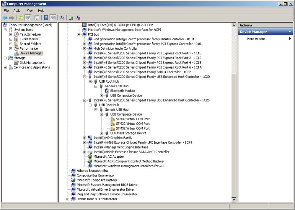

Hello Tsuneo,
Please call me Michele :) I modified a bit more the code.. 1) I duplicated the EP callbacks and I now have EP2_IN_Callback EP4_IN_Callback EP6_IN_Callback EP2_OUT_Callback EP4_OUT_Callback EP6_OUT_Callback defined like this:

similarly I modified Handle_USBAsynchXfer()as follows:

There something else to modify I think... in fact I don't see where the interrupt endpoints are handled at all! It still does not work completely but on Windows7 64bit I can see this: 0690X000006051IQAQ.png Please note that I did not install any driver.. this comes up by default. I tried linking those serial ports to the ST VCP driver with no luck.. I guess Win7 64bit is picky. On Linux, when plugging my device I have the following:
[ 074217] usb 2-1.2: new full-speed USB device number 3 using ehci_hcd
[ 196449] cdc_acm 2-1.2:1.0: ttyACM0: USB ACM device [ 196945] cdc_acm 2-1.2:1.2: ttyACM1: USB ACM device [ 197586] cdc_acm 2-1.2:1.4: ttyACM2: USB ACM device [ 197992] usbcore: registered new interface driver cdc_acm [ 197997] cdc_acm: USB Abstract Control Model driver for USB modems and ISDN adapters and three virtual COM ports appear at ttyACM0, ttyACM1, ttyACM2. But nothing flows through them. Getting there? Cheers, Michele

As we know,the vcp demo(one cdc) needs three eps,but interrupt IN is declared in the descriptor but the related endpoint is not used. And up to 16 mono-directional or 8 bidirectional endpoints can be used.So if more CDC composite can be implemented,for example 5 cdc to use all uart?
Yangfeng
tsuneo
Senior
Posted on February 26, 2013 at 07:10
The interrupt IN EP should be enabled, even if the firmware doesn't handle it.
Windows CDC driver (usbser.sys) polls the interrupt IN EP repeatedly.
When the EP returns no response, usbser.sys stops to read out the bulk IN EP, after a couple of transfers on the bulk EP.
Tsuneo
