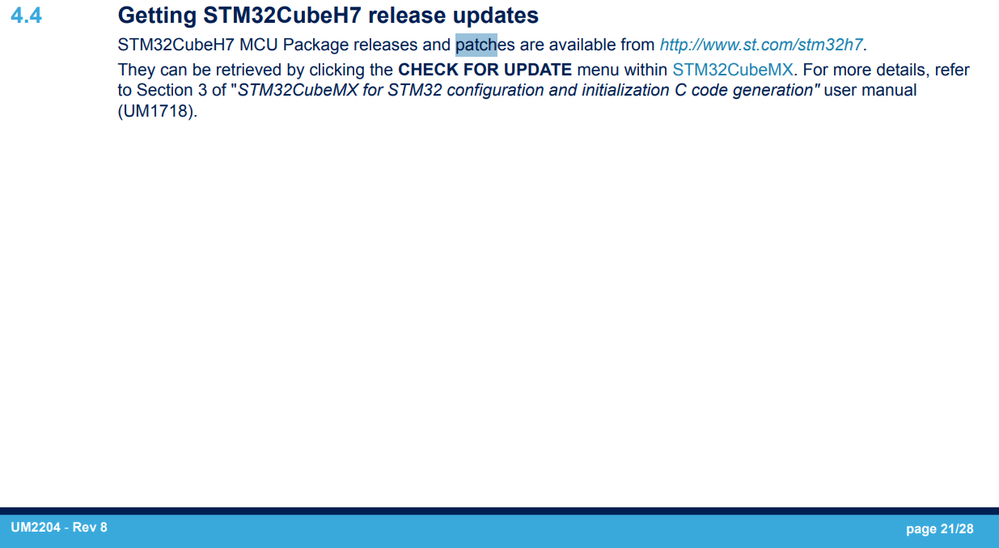

Hello everyone, I need to install the firmware support package for STM32H7 series offline. On the website (STM32CubeH7 | Product - STMicroelectronics), I found both the "STM32Cube MCU Package for STM32H7 series" and the "Patch for STM32CubeH7". What is the difference between them ?

Andrew Neil
In standard computer terminology, a "Patch" is an update to some existing software - without having to completely replace the whole thing.
For specific details, see UM2204Getting started with STM32CubeH7 for STM32H7 series MCUs:

Thank you and I already know the meaning of "patch"
Thank you, can I install firmware patch in STM32CubeIDE with "manage embedded software packages" ?
Hello @bsp ,
This functionality is well supported on STM32CubeIDE.
Under [Help] [Configuration Tool], you can manage the Embedded Software Packages.
Thanks.
Mahmoud
Thank you so much
