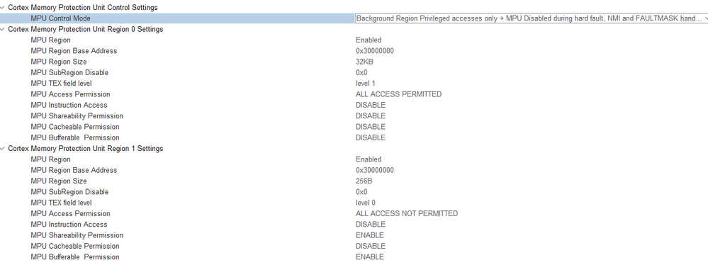

Daecheol
January 18, 2023
thank you for your comment.
I have already seen this article and modified my cubeMx MPU Base Address to 0x30000000, but as I said in the question article, when I try to debug the project, it moves to the MemMange_Handle(void) function.0693W00000Y8UAPQA3.png
