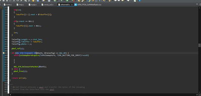

Hi, i have STM32F767 and im using FreeRTOS V2 and lwIP. Im facing known bug which should be fixed in FW_F7 V1.17 and im using FW_F7 V1.17.2 and still facing this.
When i connect the ethernet cable, after 2 seconds FW is stuck at following place:
I tried to disable DHCP everyting is ok, but when i try to ping the board the result is the same.
Can you help me to solve this issue?

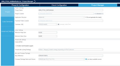

‎2024-10-24 8:57 AM
Hello STea,
i hope im using latest version of FW pack:
but the lwIP code seems to be different:
where i can update lwIP for latest version? I thought it is part of FW pack for F7 family.
‎2024-10-24 9:46 AM
Hello @Petr3 ,
you are right, the generated code with MX is generated with the old Ethernetif.c template I'm able to reproduce this and I reported it internally (ticket number 194996 internal reference only) for investigation
in the meanwhile, I suggest you make those changes to your code manually and you should be good to go.
