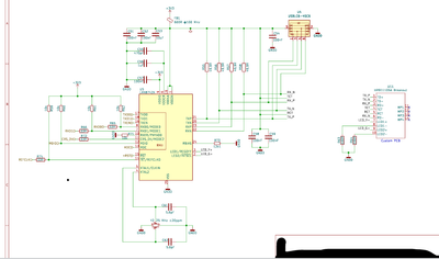

Hi Sir,
I am using the same code that works correctly on the development board. However, when I run the same firmware on the custom board, I am encountering an error.
  1. Is there any issue in the schematic related to Ethernet?
  2. Can I use the same libraries that are used in the Nucleo-H755ZI-Q board for this LAN?
  3. If I use the same library and it gets stuck at netif_add() what could be the issue?
Wood.Andy
Senior
LAN8742 pin 2 requires a 10k pull down to 0v.
Look at your working development board schematic.
Andy.

kavyamm
@Wood.Andy
Is it necessary? Can it cause any issue?
Wood.Andy
Senior
Yes - from the chip manual -
nINTSEL: nINT/REFCLKO Configuration
The nINTSEL configuration strap is used to select between one of two available modes: REF_CLK In
Mode (nINT) and REF_CLK Out Mode. The configured mode determines the function of the
nINT/REFCLKO pin. The nINTSEL configuration strap is latched at POR and on the rising edge of the
nRST. By default, nINTSEL is configured for nINT mode via the internal pull-up resistor.
You will not be getting any REF_CLK to the CPU.
They don't put spare resistors on boards ;)
Andy.
Hamady
Senior
Hi @kavyamm
I had exactly the same issue issue on my board letting INTSEL floating , i was thinking it was related to LED -
But you need to put it at GND to give clock to MCU.
