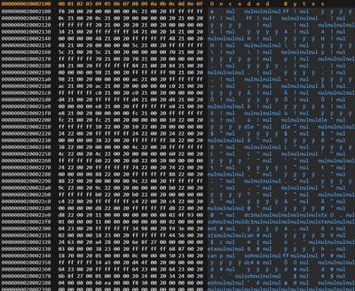

I’m using FreeRTOS V10.2.1 with a STM32WLE5 microcontroller running at 48MHz (ARM Cortex-M4) with the GCC-ARM_CM3 porting, packed in the WL package 1.3.0
My application consists of several tasks with different priorities; some of them wait for a direct notification sent by other tasks, one task wait for a queued element, others are notified from ISRs.
After a certain non-deterministic amount of time the context switching stop. By using an internal watchdog, refreshed periodically by a low priority task, this context switching problem will result in a reset. I can also reproduce the problem replacing the watchdog with a software timer to avoid reset so to break and get some informations about running status.
Stack size of each task is enough, set as twice the used one as reported in rtos analyzer during debug sessions. I do not have access to Tracealyzer; i just use the free rtos-views plugin of VScode.
All the enabled interrupt external to FreeRTOS have the same priority and equal to LIBRARY_MAX_SYSCALL_INTERRUPT_PRIORITY.
Also, different optimization levels will increase/decrease the frequency of problem during execution time.
Next is freertos config file:

I want to explain better the application:
A middle priority task is continuously notified by an ISR (relative to an EXTI interrupt) and fill a FreeRTOS queue with some values read from spi peripheral (frequency goes from 2.5 Hz to 40Hz). A low priority task will consume this data, waiting on queue. An higher priority task is notified by the ISR inside critical section as described before, with a periodicity of 10 minutes.
Rest of the time microcontroller goes to low power mode (stop2 specifically).
Next are the results of various tests done:
  • Installed last version of FreeRTOS kernel: problem persists
  • Disabled tickless idle: problem does not appear
  • When problem comes, xTickCount stop to be incremented because scheduler remains suspended (uxSchedulerSuspended = 1)
  • When problem comes those are the values of some kernel variables:
RAM Address|                 Object                       |         Value         |
0x200022e4 | volatile UBaseType_t  uxCurrentNumberOfTasks | 0x11                  |
0x20002370 | volatile TickType_t   xTickCount             | 0x278f6b              |
0x200022f8 | volatile UBaseType_t  uxTopReadyPriority     | 0x0                   |
0x20002344 | volatile BaseType_t   xSchedulerRunning      | 0x1                   |
0x200022ec | volatile UBaseType_t  uxPendedTicks          | 0x934f02              |
0x20002374 | volatile BaseType_t   xYieldPending          | 0x1                   |
0x2000232c | volatile BaseType_t   xNumOfOverflows        | 0x0                   |

 And this is a partial dump of RAM:
