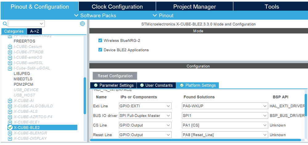

If you're using CubeIDE, you can install the X-Cube-BLE2 Package which includes examples that drive the Module
or you can download the package manually from here.
