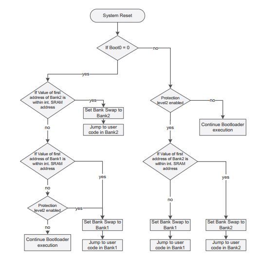

STM32L073RZ supports dual bank mechanism. Dual-bank boot capability allowing to boot either from Bank 1 or Bank 2 at startup based on BOOT pins. However, I need to jump to system boot loader from user flash using simple address based mechanism to allow the user to upgrade new code on to flash memory.
Configuration
BOOT0 pin tied to 0
Using BANK 1 flash memory
Issue
On jumping to system memory from BANK 1 Flash, control (PC) returns to BANK1 flash start address as code BANK1 code is not valid. But I wanted to control to stay in system bootloader to upgrade flash memory
Is there any way to jump to system boot loader from BANK1 user flash?

As per my understanding so far (after going through AN2606), bootloader looks for code validity on the flash bank (both 1 & 2) and jumps back to flash code if the flash code is valid. because of this dual bank mechanism control immediately switches bank to bank 1 as it has valid code.
I am looking a way to that make system bootloder to continue its execution even if it finds the valid code on the flash bank when BOOT0 pins is tied to low.
Here is the snapshot of dual bank boot mechanism from AN2606 for STM32L073XX

It's designed to allow simple programming of parts with no code on them in a production, or bricked-in-field situations.
Pretty sure I can trivially enter the loader from software, problem is having it do something different than coded in the ROM.
If you need to uses the dual banking, a short loader copied in both locations could easily fork and manage which image is used.

Bootloader can be entered:
- Pulling BOOT0 pin  high  and give reset
- Jump to Bootloader from code when some conditions are fullfilled.
Jump to bootloader is best done this way.
- Reserve some RAM that your startup code does not initialize
- Check for some magic value there early in your startup before clock/interrup setup
- If that value is given, reset that value, remap system memory and jump to bootloader
- otherwise start normal program.
- When normal program should start bootloader, set the magic value and reset the device
