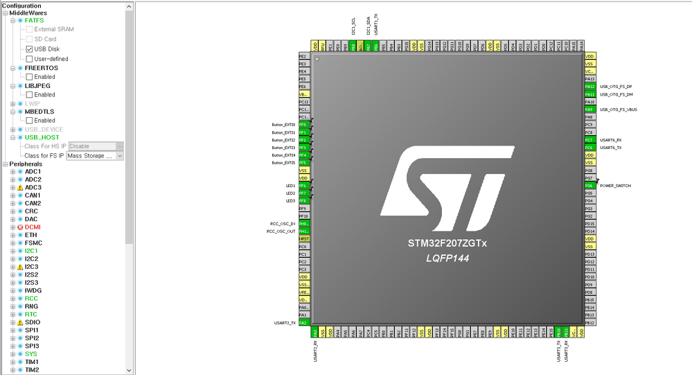

We are testing usbh mass storage using the nucleo_f207zg board.
STM32Cube_FW_F2_V1.7.0 \ Projects \ STM32F207ZG-Nucleo \ Applications \ FatFs \ FatFs_USBDisk received from the homepage is detected without any problem.

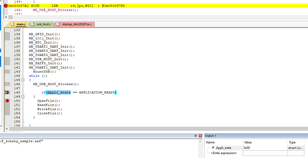

However, I created it directly as a cube (attached file) -> I tested another sample,
I can not find usb. Debugging shows that the appli_state value is still 0x00.
Does the nucleo board have characteristics? I want to solve this problem by all means.
Help !!!  I also want to design another part based on Usbh mass storage.
I attached the main / usb_host / cube file and image capture image below.
Please help me. =) Have a good day!
