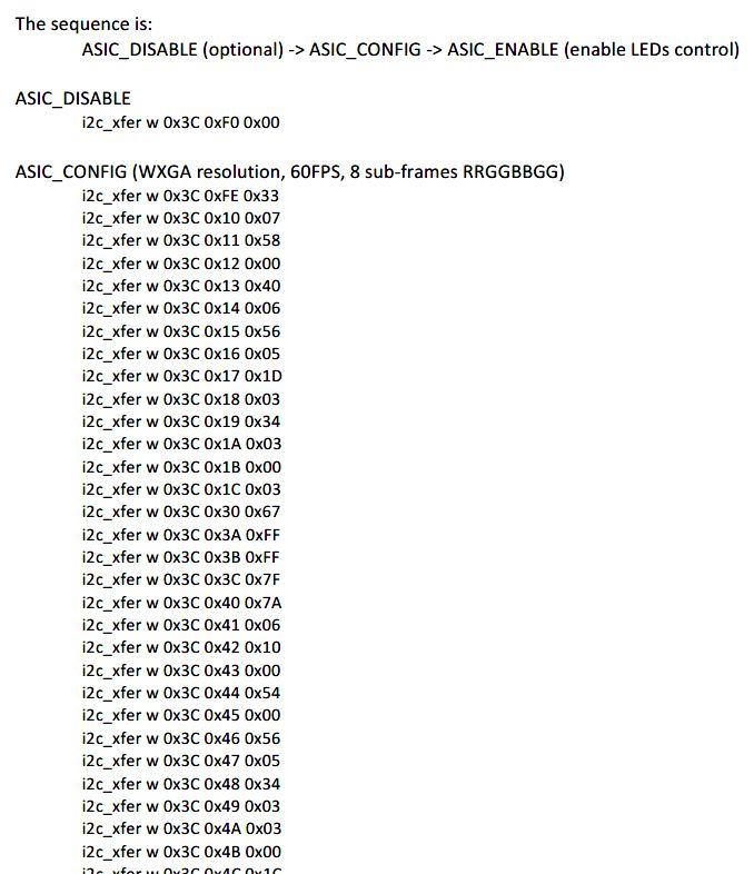

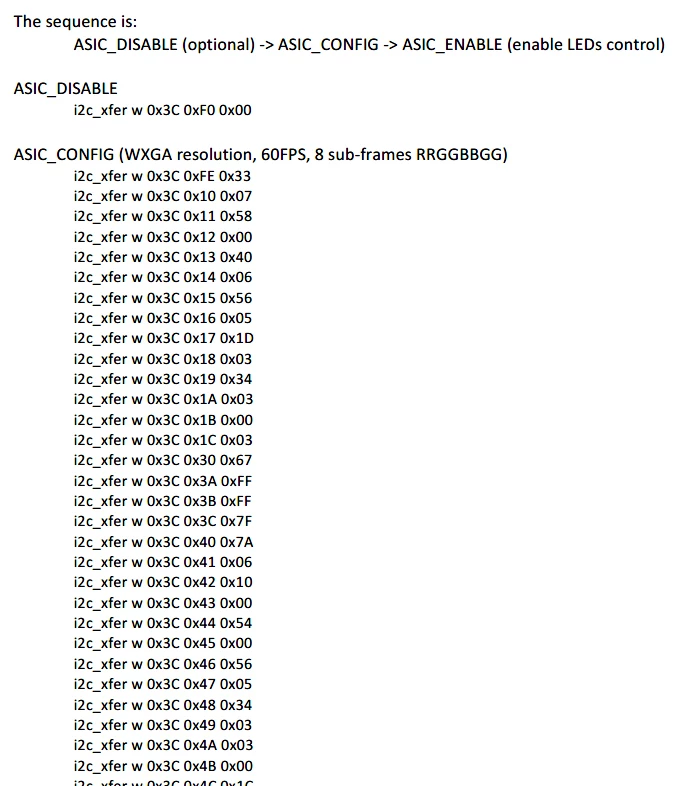

Hi everyone!
I am using the I2C to write some data to  two slave devices
this two devices need to drived by these imformation
The Board is STM32F429 discovery
the function I choose:
HAL_StatusTypeDef HAL_I2C_Mem_Write(I2C_HandleTypeDef *hi2c, uint16_t DevAddress, uint16_t MemAddress, uint16_t MemAddSize, uint8_t *pData, uint16_t Size, uint32_t Timeout)
the full code is in the ZIP file
I'm not sure this function can be use in these project,have anybody could give me some advice?
