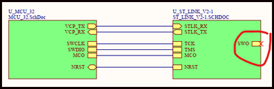

Yes... that simple. Maybe because the MCU has too few pins.
@CTapp.1 wrote:
I though that's what it used to program the target device?
SWDIO & SWCLK are used for programming and debugging.
But this thread is about using the ITM Trace output, which goes via SWO - an extra pin!
I don't think it is because the MCU has too few pins, because SWO is available on pin PB3.

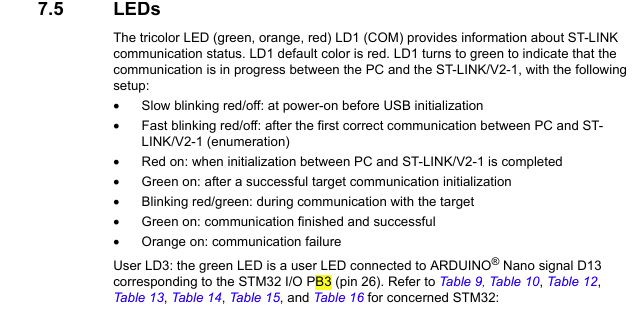

@DPiór.1 Because the chip has too few pins, they had to use PB3 for a LED:
Doh! I knew that, having just built a board that uses it!
Must read things properly before hitting "Reply" :)
