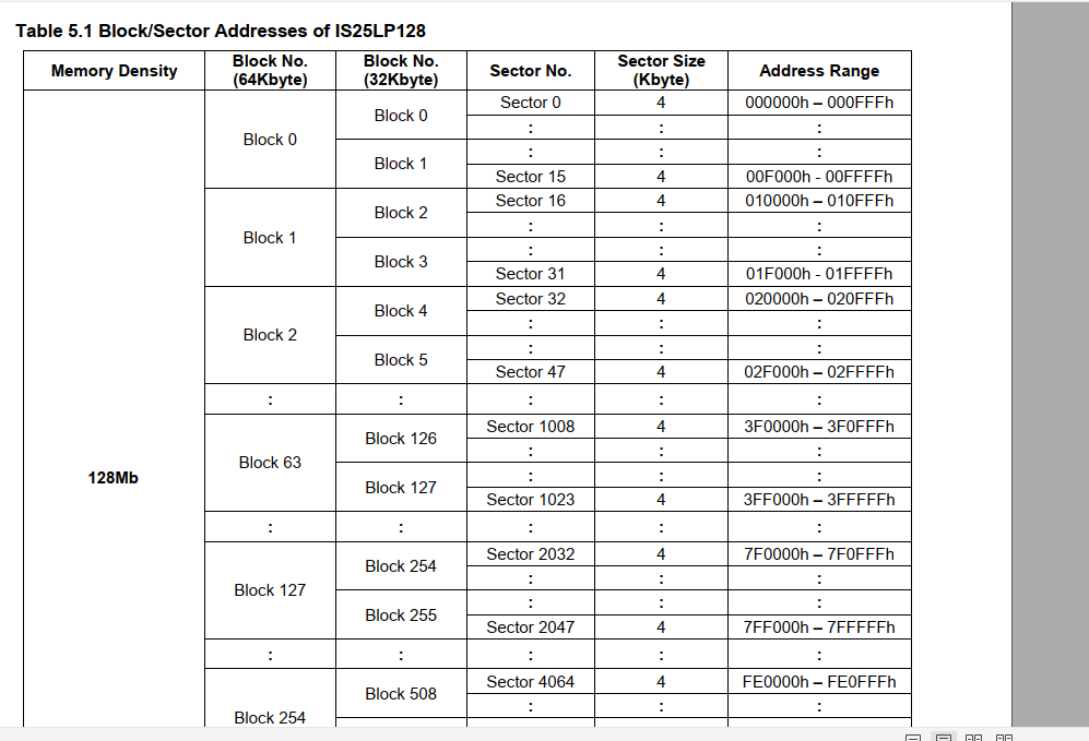

‎2022-06-09 6:14 AM
the above is the memory mapping of the device.
sector size = 4096
number of secotor = 4096
void W25qxx_WriteBuffer(uint8_t* pBuffer, uint32_t WriteAddr, uint16_t NumByteToWrite)

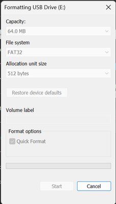

‎2024-06-24 7:31 AM
Hello @ykn & @Tesla DeLorean ,
