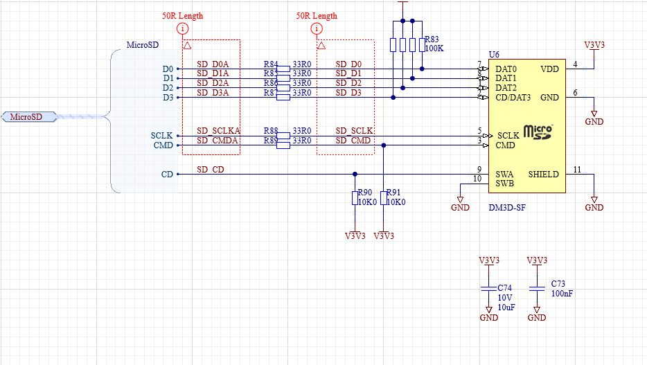

schematic of the SD card adaptor:0693W00000AMlhCQAT.pngI configured the following in CUBEMX:

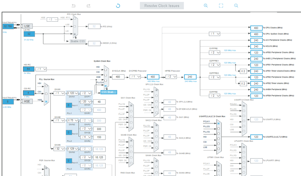

My clock config:0693W00000AMlmkQAD.pngWhen i run the following code :

When i test the signal on the oscilloscope i notice that:
From the start of the f_mkfs function the CLK is always 400KHz, even if i change the clockvalues
CD responds with short HIGH signal.
All data busses are completely empty, (no data)

set port pin pullups and speed to medium ;
