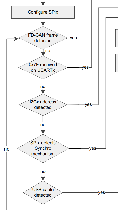

MM..1
January 13, 2023
Need check and read better
0693W00000Y8DXUQA3.pngorder for detection if other interface is marked as detected SPI ...
Check too schematics and table 107 pinout usw.

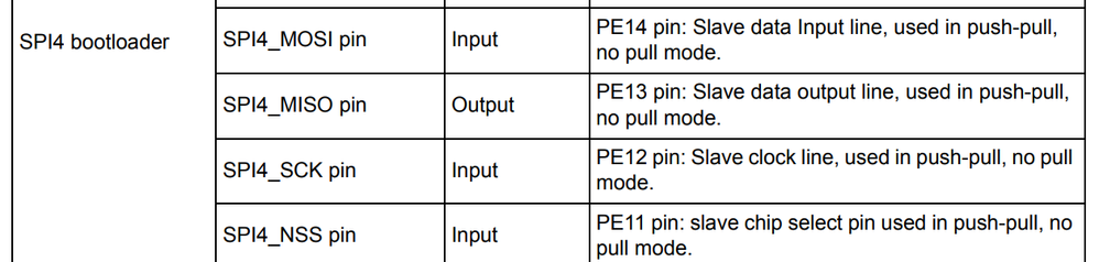

MM..1
January 17, 2023
Read AN2606 better, only this pins is SPI4 for bootloader
0693W00000Y8RAZQA3.pngand i send you diagram for you see SPI is on end check , then if detected is any other first ...
but your issue is bad pinout used maybe. (no info from your message)

Thanks for following up. Yes, we are using PE11 for SPI4_SNN, PE12 for SPI4_SCK, PE13 for SPI4_MISO, and PE14 for SPI4_MOSI. Also as mentioned before, we have followed the ST recommendations on Table 108 of AN2606 to "supposedly" avoid bootloader to choose another interface other than SPI4.
