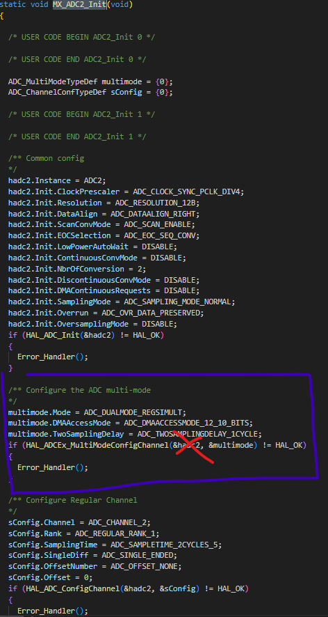

I've put together an IOC file and generated code with no changes from the generated code, and when that code initializes ADC2, the error handler gets called when HAL_ADCEx_MultiModeConfigChannel fails after a call to ADC_MULTI_SLAVE. I'm not sure what it's doing, but I must be missing something in the IOC model since it can't get through the init code.

This is a CubeMX generation problem, CubeMX calls HAL_ADCEx_MultimodeConfigChannel in the ADC2 config while this function should only be called with the ADC master (ADC1).
The blue box function must therefore be removed:
Okay, that works.
