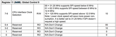

I am trying to interface to a 3 port switch "Micrel ksz8863" using the MDIO interface. I have setup the eth peripheral and I can measure activity on the data and clock pins on the MCU. I measure a clock speed of 1.75 Mhz. But when I try to debug, the data I get returned from the PHY is always 0xFFFF and HAL_OK.

Reading the datasheet, I aspect to read something else from just 0xFFFF. Se foto where register 0x0B is something else than 0xFFFF.
