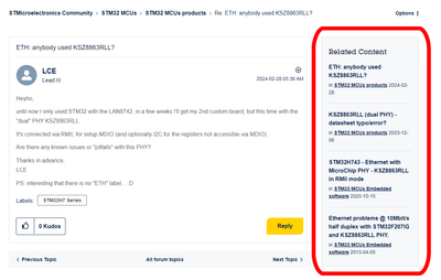

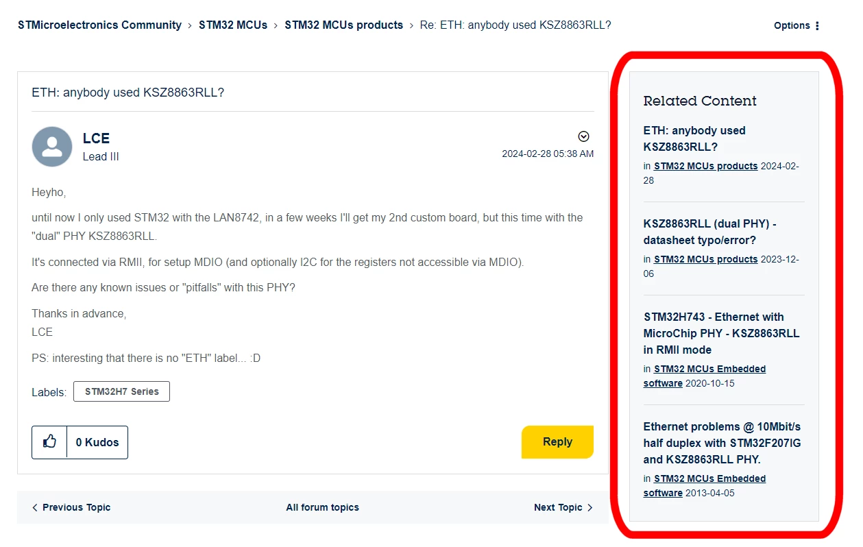

February 28, 2024
Just noticed:
LCE
LCEAuthor
Principal II
February 28, 2024
Yes, I already found these, one thread was started by me...
And I'm not too bad at googling! ;)
