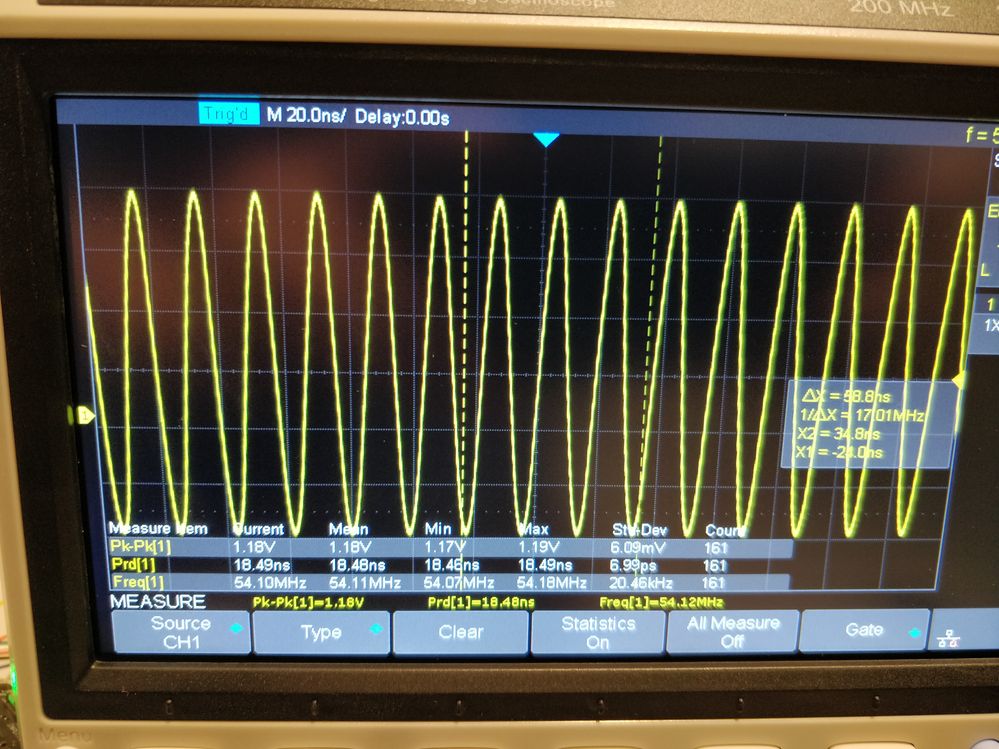

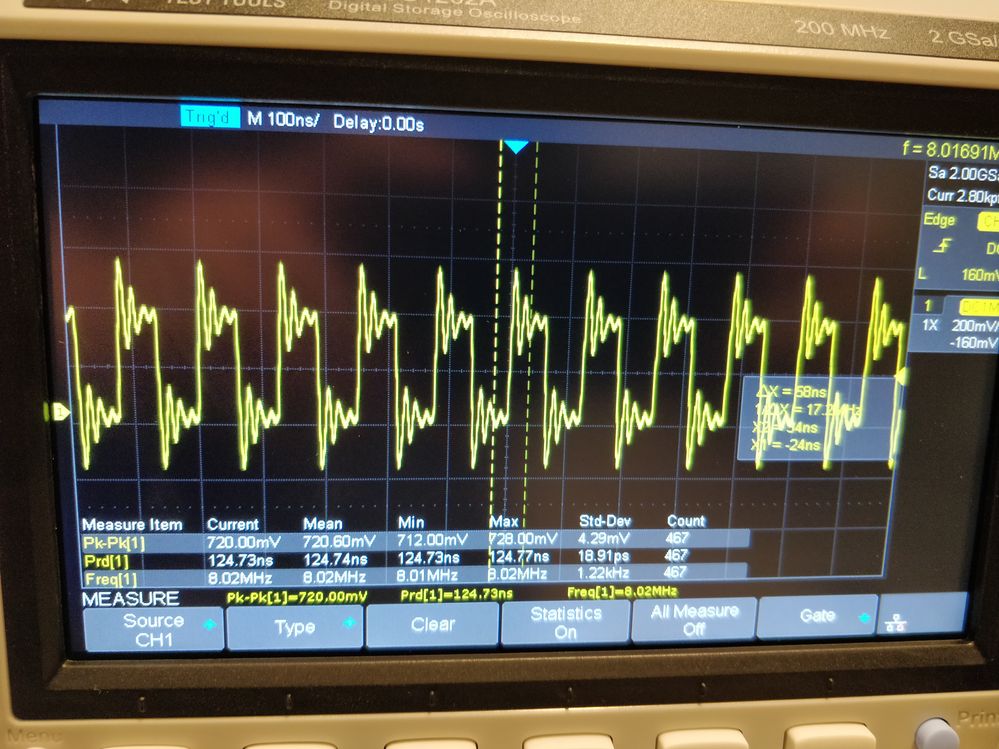

‎2019-12-05 9:17 AM
Hi again!
I finally got hold of a 200MHz - 2 GSa/s oscilloscope, which confirmed what we suspected - the HSE oscillator is 0.2% faster than the nominal value.
We can see that in the following pictures:
1) HSE without division:
Nominal: 8 MHz
Real: 8.02 MHz
2) SYSCLK divided by 4:
Nominal: 216 / 4 = 54 MHz
Real: 54.11 MHz
This solves the issue - I just need to either accept or get a more accurate HSE.
Thanks a lot for the help!
