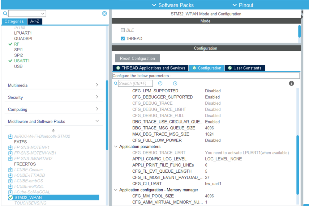

  6. Under Middleware ->STM32_WPAN-> Check THREAD and set up the configuration as follow :

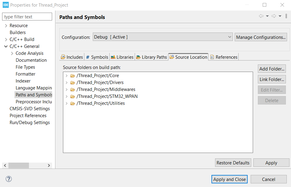

  9. Generate the project and verify the project setting to be sure that all source path are included as follow :Ouadi_3-1707936599295.png
