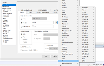

HI Guys,
Sorry to bother you...
 Now I was working use STM32C0XX series chips, my development tools is IAR8.50, and find that IAR8.50 can't show STM32C0XX series chip, I had check some data: someone said should upgrade IAR FW, others said I should add STM32C0XX Lib config files into IAR development, but I can not find where I can download STM32C0XX config lib, so what should I do?
mƎALLEm
At the time IAR v8,50 was released, STM32C0  series were not available. The IAR patch to support C0 device can be found in STM32CubeC0 package here:
https://github.com/STMicroelectronics/STM32CubeC0/blob/d99c0f7a6b387e265f7b6939d3883097a4125cf6/Utilities/PC_Software/IDEs_Patches/EWARM/EWARMv8_STM32C01x-03x_V1.0.zip

Check if there is a Software Patch directory in the CubeC0 repository for IAR
