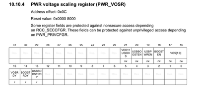

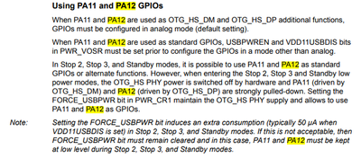

Hello @Yang Yang @Elatewendy
According to the part 10.7.12 of the RM0456, "When PA11 and PA12 are used as standard GPIOs, USBPWREN and VDD11USBDIS bits in PWR_VOSR must be set prior to configure the GPIOs in a mode other than analog".
Best Regards.
Best Regards.

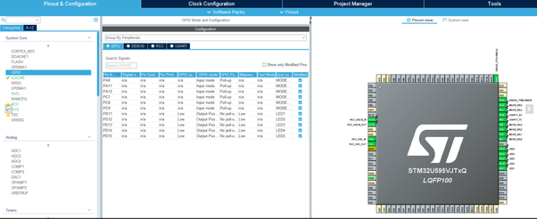

hello,@STTwo-32.
I asked the same question at https://community.st.com/t5/stm32-mcus-products/stm32u595-used-pa12-and-pa11-as-input-gpios-can-t-get-the-high/td-p/635837 .
I made a mini project to read the registers.The GPIOA register are ZERO...
The result like as:
HW VERSION 001001
reg_pwr_init = 0x7c000
reg_pwr = 0x2fc000
reg_gpioa = 0x6700

And the gpios configured like this:
