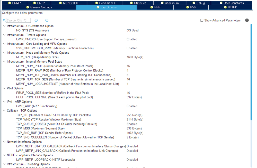

I maked simple program with LWiP. After I got dinamyc address, I tried socket connection and call netconn_bind halted MCU.
My code:

Please, help me resolve this problem.
LWiP settings in CubeMX:
Andrew Ivanov
This problem solved as follows, I ran functions netconn_new, netconn_bind, netconn_connect in separate thread. This thread maked with function sys_thread_new.
And, it`s ok in my case.
