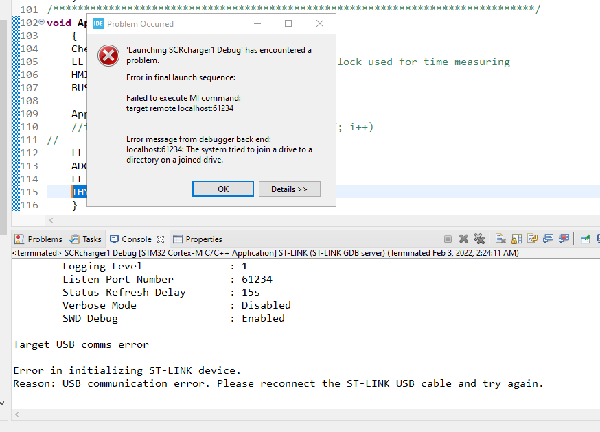

Hi guys
I am using TrueStudio and trying the Nucleo 64 STM32F446RE.
when I try to debug, the console always shows
Starting server with the following options:
Persistent Mode : Disabled
Logging Level : 1
Listen Port Number : 61234
Status Refresh Delay : 15s
Verbose Mode : Disabled
SWD Debug : Enabled
Target USB comms error
Error in initializing ST-LINK device.
Reason: USB communication error. Please reconnect the ST-LINK USB cable and try again.
I checked to use the STM32-LINK Utility. There is a communication error.
Tried to execute dpsint_amd64 using the path C:\Keil_v50\ARM\STLink\USBDriver
changed the USB cable

‎2022-02-02 2:59 PM
I have the same problem with STM32CubeIDE 1.8.0
‎2022-02-22 11:52 AM
I solved the problem by reinstalling ST-LINK server software!
‎2022-02-25 3:38 PM
The problem comeback today! :crying_face:
‎2022-03-09 2:23 PM
Update to STM32CubeIDE V1.9.0 solves all problems.
Thanks ST:smiling_face_with_smiling_eyes:
