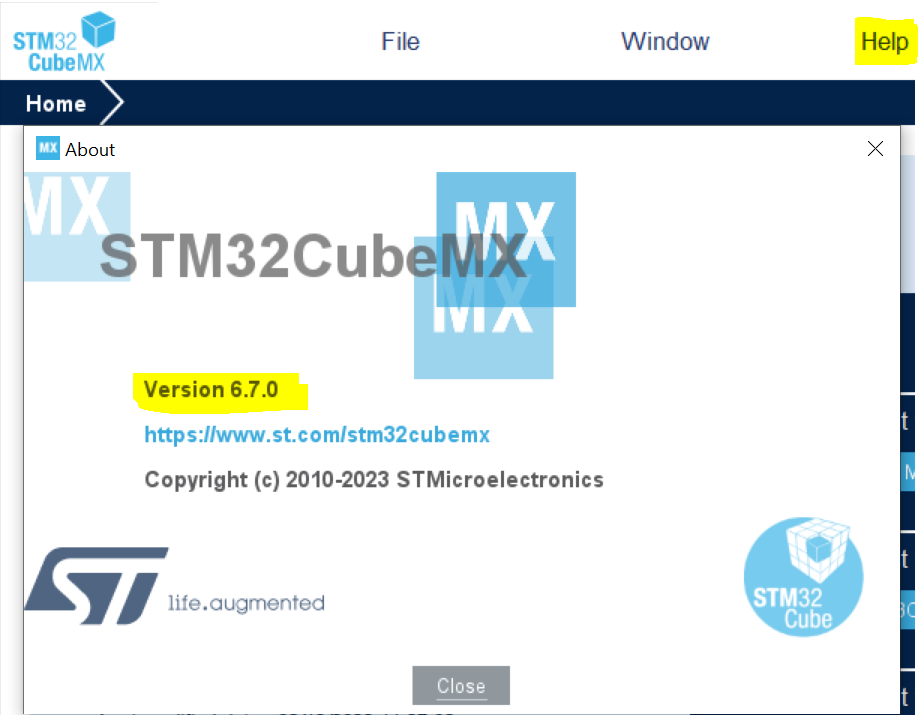

In order to reproduce your case with the same environment,
Could you please mention which CubeMX version you are using ?
Regards
Mahdy
I'm using STM32CubeIDE 1.10.1.
I'm asking about STM32CubeMX version (not STM32CubeIDE)
As mentioned below :
0693W00000Y7DYVQA3.pngGo to STM32CubeMX --> help --> About
I don't have STM32CubeMX. Only STM32CubeIDE.
