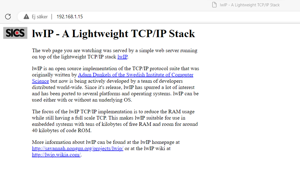

Yes. Now it's working.
I tried both with FreeRTOS and without FreeRTOS. With FreeRTOS, the connection was slow, or sometimes my webbserver did not responds. It was due to threads doing something else. Sometimes it works, sometimes not.
But without FreeRTOS. I just only need to write this code in main.c file
/* HTTP Deamon */
  httpd_init();
  /* USER CODE END 2 */
  /* Infinite loop */
  /* USER CODE BEGIN WHILE */
  while (1)
    /* USER CODE END WHILE */
    /* USER CODE BEGIN 3 */
	  MX_LWIP_Process();
  /* USER CODE END 3 */
0693W00000Y7Jw4QAF.pngAnd my webbserver host directly. I like it. So yes. it was the "const" datatype that causing this error.
By replacing Ethernet MAC onto RAM instead of FLASH. Is this a bug in STM32CubeIDE firmware for STM32F407 series?
Thank you so much.
