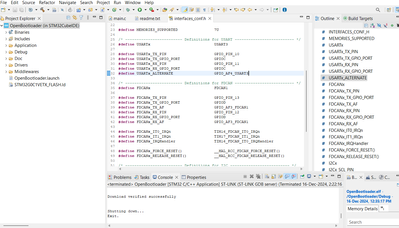

To be able to use the UART3 instead of UART1 you should update the lines below in the file interfaces_conf.h.
#define USARTx                            USART1
#define USARTx_TX_PIN                     GPIO_PIN_9
#define USARTx_TX_GPIO_PORT               GPIOA
#define USARTx_RX_PIN                     GPIO_PIN_10
#define USARTx_RX_GPIO_PORT               GPIOA
#define USARTx_ALTERNATE                  GPIO_AF1_USART1
Saket_Om
Hello @Saket_Om ,
Following changes have been made in code, but not connecting to desired UART.

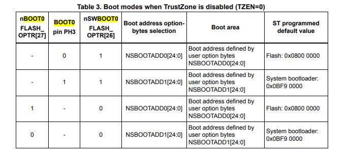

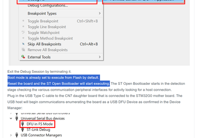

 2) Do we also need to do BOOT0 pin PH3 as HIGH?
Yes, the BOOT0 pin PH3 should be HIGH to boot on system bootloader. Please refer to the section "3.6 Boot modes" in the reference manual for more details.
Saket_Om
Hello @Saket_Om ,
As per the highlighed text, I think Boot0 pin setting to 1 is not required at least for the OpenBootloader code presently I'm trying to use.
Hello @Saket_Om ,
Even after clock changes it's not recognizing UART3 interface.
When I try to debug the code, it stucks at "SystemClock_Config()".
