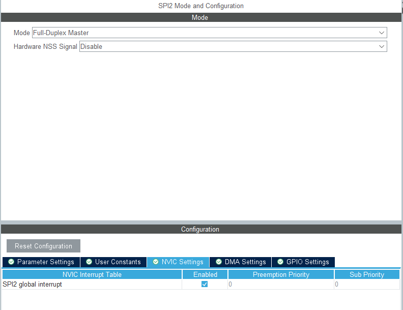

We are performing SPI communication using DMA.
In this case, we manually set the GPIO to High/Low as SPI_CS, but (obviously) SPI_CS goes High before all of the SPI CLK is sent.
How can we manually return SPI_CS to its original state after all of the SPI CLK has been sent?
Should We use SPI_DMATransmitReceiveCplt?

‎2024-12-23 6:39 AM
Hello @pass3master
- You need to set the SPI global interrupt in the .ioc.
- In your code call HAL_SPI_TransmitReceive_DMA() and then set CS high in the HAL_SPI_TxRxCpltCallback().
Thanks
Omar

‎2024-12-23 1:56 AM
SPI_DMATransmitReceiveCplt is not called. Is there something we need to set? Do we need to set the ioc file?
‎2024-12-23 2:10 AM
Have you enabled the interrupt?
‎2024-12-23 2:19 AM
By interrupt, do you mean a DMA interrupt?
The DMA1 stream2 global interrupt (the DMA stream we are using) is enabled.
The target SPI global interrupt is disabled.
‎2024-12-23 5:17 AM
You should set CS high in HAL_SPI_TxRxCpltCallback.
If that's not working, show the relevant code. Ensure DMA interrupts are enabled.
‎2024-12-23 6:39 AM
Hello @pass3master
Thanks
Omar
‎2024-12-23 4:21 PM - edited ‎2024-12-23 4:49 PM
Thank you for your reply. I was able to solve it thanks to you.
