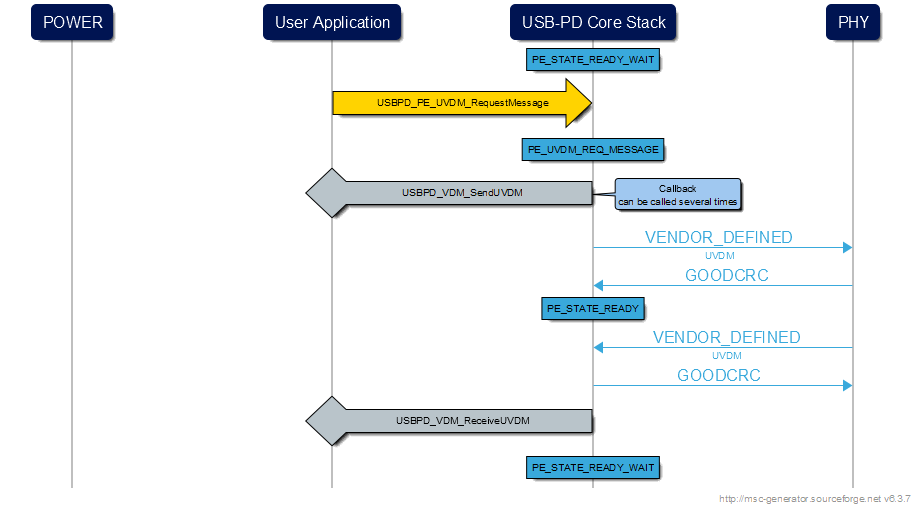

Here is the associated Message Sequence Chart you can refer to:0690X00000AqfEwQAJ.png
To fill data, you have to complete the following callbacks functions in usbpd_vdm_user.c file:

2 REPLIES 2
Yohann M.
Hello
