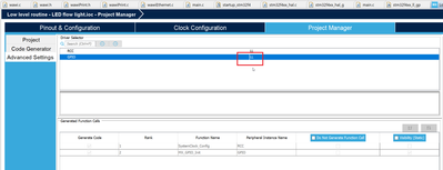

This approach is done in the LL (alternative to hal) functions to read ports:
* @brief Return full input data register value for a dedicated port.
* @rmtoll IDR IDy LL_GPIO_ReadInputPort
* @PAram GPIOx GPIO Port
* @retval Input data register value of port
__STATIC_INLINE uint32_t LL_GPIO_ReadInputPort(GPIO_TypeDef *GPIOx)
return (uint32_t)(READ_REG(GPIOx->IDR));
But therefore you need to enable in cubemx the LL functions for GPIO.
