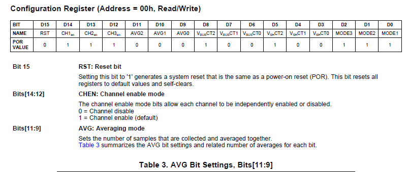

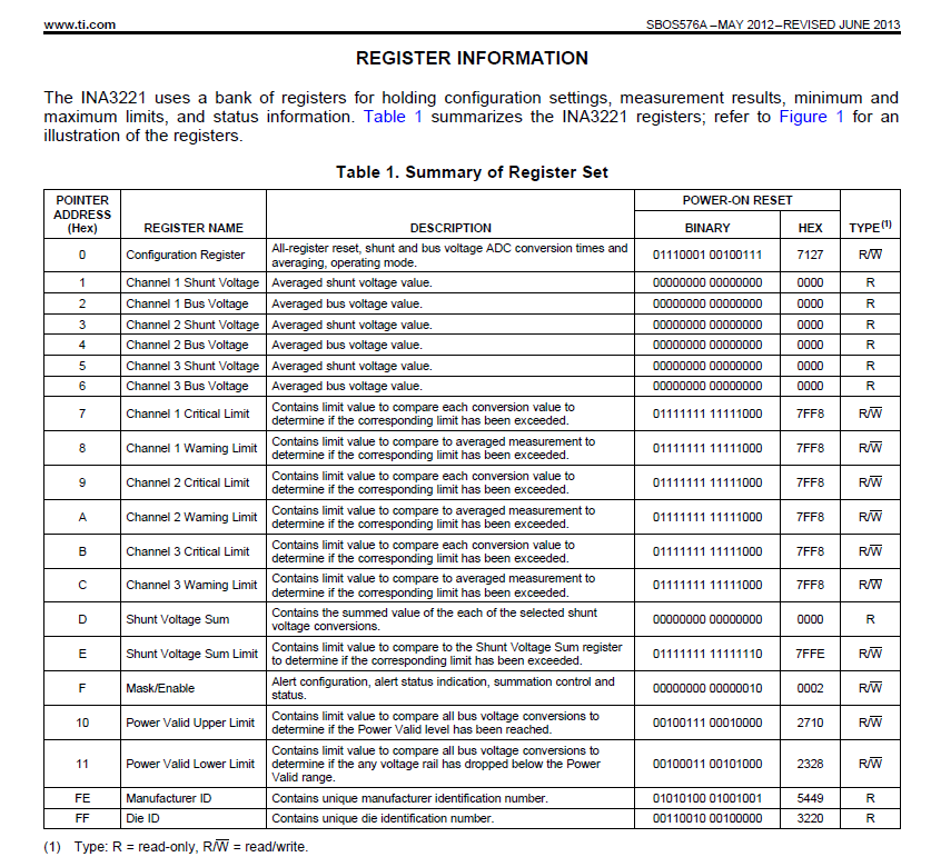

The INA3221 sensor has 16 bit registers. I am just getting startet and wanted to check/read the value of the configuration register (0x00) after writing my own config to it (config value: 0x7FFF).
I guess I am doing the write operation wrong but I dont quite now what to change:

uint16_t mycfg=0x7FFF; //All channels enabled, 1024 averaging samples, 8.2ms BV CT, 8.2ms SV CT, and all continuous measuring

If I set the memory size to 8 and the amount of data to 2 in both the read an write function I get 0x2771 as my register value which is also not what it should be. 0x2771 might represent the power on reset value of 0x7127.
Below is the register map of the INA3221.
I appreciate any hint on what I am getting wrong.

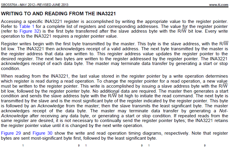

The I2C bus has a specification, and this spec defines only byte (8-bit) transfers.
I suppose this specifies the transfer order in the sensor datasheet:

So in other words the HAL_I2C_Mem_Write/Read work the other way around right? LSB first and MSB last. So every time I was trying to configure the INA3221 I actually reset it beacuse the MSbit=Resetbit was 1.
If I write "uint16_t mycfg=0xFF7F;" to the register, the value I read from the register is the same.
Thanks, was kind of obvious but somehow I missed it.
‎2021-03-09 7:28 AM
MSB might also mean Most Significant Byte.
Look at page 30 of the datasheet, approximately in the middle.
Tha chapter beginning there describes the chip's I2C interface in more detail.

Many i2c devices have "big endian" convention.
Try to read some register with well known content, like the device version, then you will know.
-- pa
