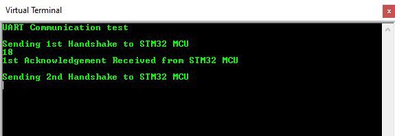

I've tried making a consecutive send to the STM32 serial buffer but it won't work.
This is my code in STM32:
uint8_t handshake_ATmega = 0;
uint8_t handshake_ATmega2 = 0;
uint8_t Ack_ATmega = 0x18;
uint8_t Ack_ATmega2 = 0x30;
  while(1) {
	  HAL_GPIO_TogglePin(GPIOA, GPIO_PIN_0);
	  HAL_Delay(500);
	  if (__HAL_UART_GET_FLAG(&huart2, UART_FLAG_RXNE) == SET) {
		  HAL_UART_Receive(&huart2, (uint8_t *) &handshake_ATmega, 1, 100);
		  if (handshake_ATmega == 0x20) {
			  HAL_UART_Transmit(&huart2, (uint8_t *) &Ack_ATmega, 1, 100);
			  HAL_GPIO_WritePin(GPIOA, GPIO_PIN_1, GPIO_PIN_SET);
			  //HAL_Delay(500);
				  HAL_UART_Receive(&huart2, (uint8_t *) &handshake_ATmega2, 1, 100);
				  if (handshake_ATmega2 == 0x40) {
					  HAL_UART_Transmit(&huart2, (uint8_t *) &Ack_ATmega2, 1, 100);
					  HAL_GPIO_WritePin(GPIOA, GPIO_PIN_2, GPIO_PIN_SET);
					  HAL_Delay(500);
					  break;
				  else {
					  continue;
		  else {
			  continue;
And this is the code in Arduino:
uint8_t handshake1 = 0;
uint8_t handshake2 = 0;
  Serial.begin(9600);
  Serial1.begin(9600);
  Serial.println("UART Communication test\r\n\n");
  Serial1.write(0x20);
  Serial.println("Sending 1st Handshake to STM32 MCU\n");
  while(1){
    if (Serial1.available()){
    handshake1 = Serial1.read();
    Serial.println (handshake1, HEX);
      if (handshake1 == 0x18){
        Serial.println("1st Acknowledgement Received from STM32 MCU\r\n\n");
        delay(500);
        Serial1.write(0x40);
        Serial.println("Sending 2nd Handshake to STM32 MCU\n");
          handshake2 = Serial1.read();
          Serial.println (handshake2, HEX);
          if (handshake2 == 0x30) {
            Serial.println("2nd Acknowledgement Received from STM32 MCU\n");
            break;
This is the output in the serial monitor:
0693W000008wVucQAE.jpgIt works in the first handshake and acknowledgement, but it wont work on the second.
What is wrong with this?
Well, I won't debug deep into your code. Add some tracing as described here STM32 microcontroller debug toolbox. A first glance it seems like after the condition in line 10 is fulfilled for the very first time, the condition in line 19 is not immediately fulfilled and the prog continues, reading the 2nd handshake with the first transmit?
Generally speaking: better use a (simple) state machine than hard coding the communications flow.
hth
KnarfB

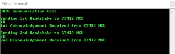

I managed to get the right code. But I feel this is not very efficient, gotta learn to use the HAL library more.
STM32 Code:
while(!break_loop) {
		  HAL_Delay(500);
		  __HAL_UART_CLEAR_FLAG(&huart2, UART_FLAG_RXNE);
			  HAL_Delay(500);
			  HAL_Delay(500);
			  while (1) {
					  HAL_Delay(500);
						  HAL_Delay(500);
						  HAL_Delay(500);
						  break_loop = 1;
						  break;
					  else {
						  continue;
		  else {
			  continue;
Arduino Code:
while(!break_loop){
    delay(500);
        delay(500);
        while(1) {
            delay(500);
              delay(500);
              break_loop = 1;
              break;
            else {
              continue;
      else {
        continue;
Serial Monitor Output:
Bails early if no data available, doesn't have a re-entry strategy
