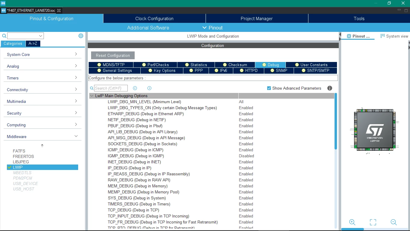

I was able to activate the messages for USB Host, but I am not able for LWIP, it seems that there is a specific combination of options, so that messages are enabled
Thank you.

Add to your lwipopts.h,
#define LWIP_DEBUG 0
//#define NETIF_DEBUG LWIP_DBG_ON
//#define DHCP_DEBUG LWIP_DBG_ON
//#define UDP_DEBUG LWIP_DBG_ON
//#define MEMP_DEBUG LWIP_DBG_ON
//#define MEM_DEBUG LWIP_DBG_ON
//#define ICMP_DEBUG LWIP_DBG_ON
Uncomment whichever topic you want logging.
