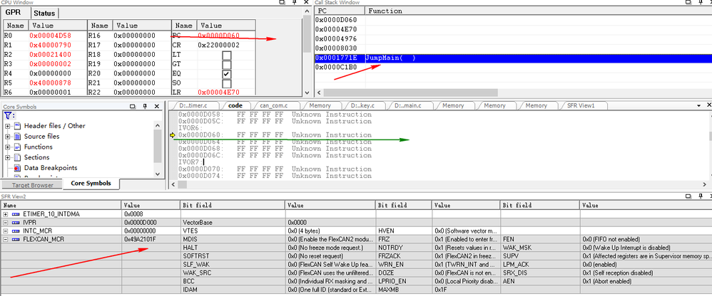

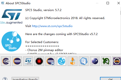

Posted on June 14, 2018 at 12:17
could you try to update spc5studio to 5.8? in alternative you can change can_lld.c with the one attached (there is a new instruction in can_lld_stop).
Moreover, can you send the callstack window in UDE when IVOR occurs (views-->call stack window) and flexcan MCR register value (views->sfr view-> right click->browse)?

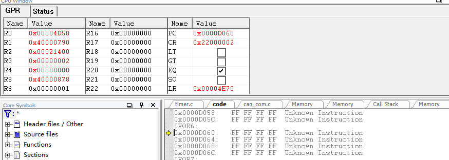

Posted on June 14, 2018 at 10:51
Hello procolo?
   Here are the pictures
1. Version of SPC5studio
2. ivor6 but sometimes it seems to enter ivor1 after jump
3. can_lld_cfg.c files is in the attachment.
4. yes, I think its the same result.

procolo
Senior
Posted on June 14, 2018 at 14:06
the only way to understand the issue is to debug your code.
Could you please send me your apps and instructions?  I will debug on my side
Posted on June 14, 2018 at 13:01
Hello procolo?
                  I will try the second scheme?here is my callstack and flexcan MCR register.0690X0000060LGHQA2.png
Thanks!

Posted on June 20, 2018 at 06:00
Hello procolo:
   so much thanks for your kindly help,my problem has been solved ,it was the IVORS didn't been initialized correctly after jump to the bootloader.
Best regards!
