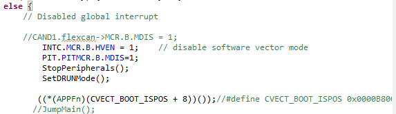

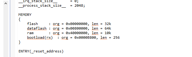

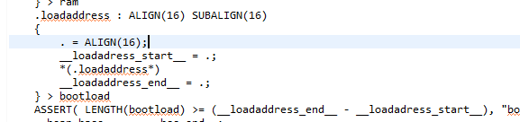

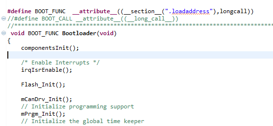

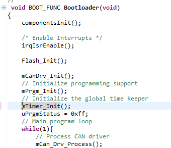

Posted on June 13, 2018 at 12:46
Hello Procolo?
 Thank you for your reply?I have jumped successfully from bootloader to application program?and it was run well?but I have problems jumping form APP to bootloader which has a function located at 0xb800?I used the same jumping function. and I could find it already jumped to the address 0xb800 through the PC pointer?however it seems failed at the initialization func ?and the PC pointer stop at 0x00000c14 which was put the vectors seen from the map doc.
SPC5_CLOCK_FAILURE_HOOK();
and I found  it was really curious that if I close everything in APP ,only the jump func left , it  could jump successfully. Is there any connections between the PC pointer  address which the  jump func located and the aim bootloader func address which I need to jump to?Do I describe clearly?I need your help?thank you so much again?
linker file
destination
the jump code

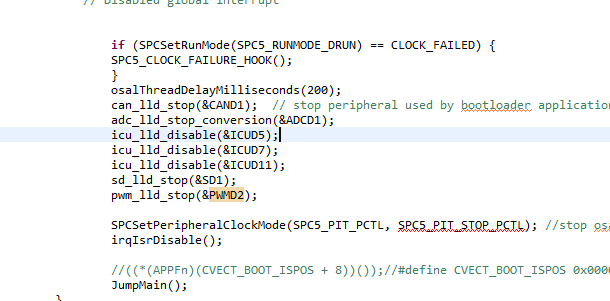

procolo
Senior
Posted on June 13, 2018 at 16:30
before jumping, could  you please try to disable interrupts after stopping the peripherals?
actually , some stop functions re enable when exit , so if you disable interrupt before stopping peripherals they may be re enabled when jumping.
Redards,
Procolo
Posted on June 13, 2018 at 15:36
Hello
Procolo:
      I have copied your code when I jump,but it did‘t work, I disabled all the peripheral and find that the if the  adc_lld_stop_conversion(&ADCD1); was disabled ,then it worked。But if I tired more ,I found it did not run successfully everytime, I traced the PC in CPU window ,found that the PC was sometimes in IVOR6 or sometimes in IVOR1,what should I do to find the problem?many thanksï¼�
Posted on June 14, 2018 at 04:43
Hello
Procolo?
      I think I have disabled the interrupts after
stopping peripherals?but it still entered the IVOR6,  I can?t find where the problem is?here are my application code and the bootloader code? I copy the code from your answers?and is I don't init any
peripherals
 in app? it can jump successfully? it is so weird. There are only peripherals of  can and timer.
procolo
Senior
Posted on June 14, 2018 at 08:11
my idea is that there is some peripheral which is not correctly stopping and lead to an error when jumping.
we should understand which one is. could you try to enable one peripheral at a time and check when it does not work?
also, please try to set DRUN mode as last operation before jumping:
  • stop peripherals
  • irq disable
  • DRUN
Regards,
procolo

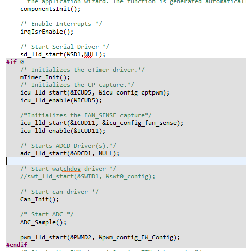

Posted on June 14, 2018 at 09:16
Hello procolo:
      Thank you for your tips. I have changed my code as your proposal,Then I initialized my peripheral one by one , and  found it maybe the CAN does the effect, if there is only initialization and TX message, it is OK to jump, but if there are message for rx, the program enters IVOR6 even if I have stopped the CAN module.Do you  have any opinion to solve this?
