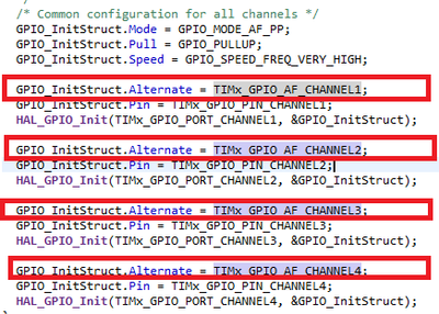

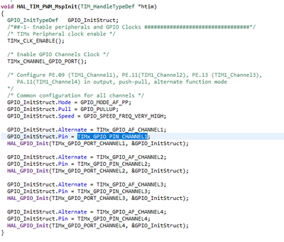

I see the four GPIO pins are initialized:

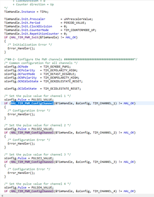

And I see the four PWM channels are setup:
But I can't find the code where each GPIO pin is bound to each PWM channel or the ISR where each GPIO is toggled whenever a PWM channel interrupt occurs.

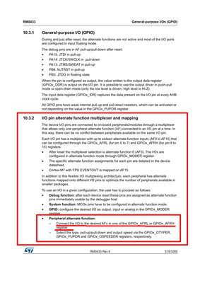

I’m not sure I understood the question but .Alternate member of the GPIO structure is the one responsible of linking the timer functions or any other peripheral functions to the GPIOs.
You need to refer to the reference manual of the product and there is a table showing tha mapping of these alternate functions on the GPIOs.

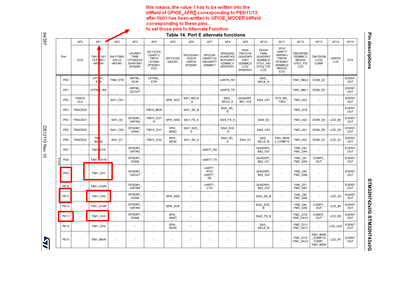

It seems that the alternate function is specified here when configuring a GPIO:
Thanks for the information.
