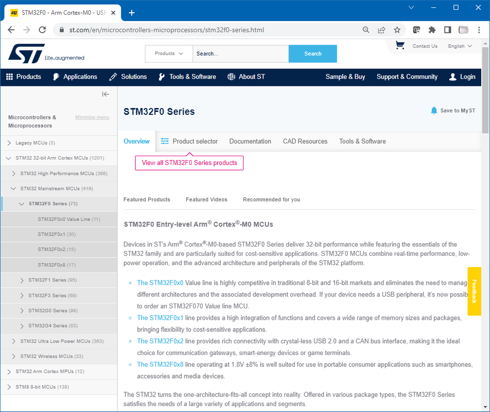

@amlok.1​ "Do you know an MCU that can get this data for my sensor via USB"
Finding an MCU is the easy bit!
You can look on the ST Product Pages; eg,
0693W00000NqZxYQAV.pngalthough, from that, it looks like F0 has only USB Device?
So look at the other families...
Having found an MCU with the hardware facilities, you're then going to have to develop the firmware for communicating with this sensor.
Do you know what USB Class your sensor presents, and how to communicate with it over USB?
