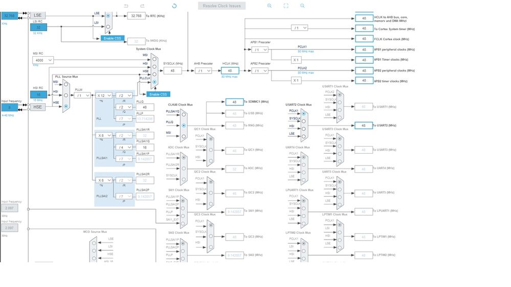

HI, I have STM32L476RG nucleo board. I have interface a SD card using SDMMC. I have configured SDMMC as 4bit mode with TX, RX in DMA mode. I have configured FATFS. I have given 47K pull up to DO to D3 and CMD line. I am using CUbeMX 5.5.0. The FATFS version is R0.12c.
0690X00000BwcW5QAJ.jpgWhen I generate the code and compile, I get error of
void HAL_SD_AbortCallback(SD_HandleTypeDef *hsd)
weak void HAL_SD_TxCpltCallback(SD_HandleTypeDef *hsd)
weak void HAL_SD_RxCpltCallback(SD_HandleTypeDef *hsd)
as defined twice in BSP_driver_SD.c and stm32l4xx_hal_sd.c
SO I commented in BSP_driver_SD.c and the code complied.

I uploaded the below hex file STM32L476RG_NUCLEO_TEST_SDMMC_001.hex and I am getting
Core=80000000, 80 MHz     CPUID 410FC241 DEVID 415 REVID 1007
Cortex M4 r0p1                STM32L475xx, L476xx or L486xx
C0000000 00000000 00000000 10110021 11000011 00000000
FPU-S Single-precision only HCLK=80000000
APB1=80000000                      APB2=80000000
MCLK=4000000
FatFs Testing (87030)
SystemCoreClock: 80000000
Mounting FatFs
Switch to 4-Bit
R 8192 1 (00000002)
res = 13 f_getfree
Infinite loop...
Nothing is written on the SD card.
How large is the card? Is it using EXFAT or NTFS?
Try a FAT formatted card of 32GB or less.​
Check also wiring and socket. I'm using quality PCB, and wiring only several inches long, and uniform.​

I have programmed by nucleo-L476RG board from STM32Cube_FW_L4_V1.15.0 ( provided by STM)
D:\en.stm32cubel4_v1-15-0\STM32Cube_FW_L4_V1.15.0\Projects\STM32L476G-EVAL\Applications\FatFs\FatFs_uSD_Standalone
the f_open function creates the a text file STM32.txt in my SD card. but f_write function return error. SO f_write is not working.
Since I am able to create a STM32.TXT in my SD card, I assume my electrical connections are OK. Also I am getting SDMMC_CK as 24MHZ on the oscilloscope.
(SDMMC_CK = SDMMCCLK / [CLKDIV + 2])
MY SD card is FAT32 format 16GB SDHC.
