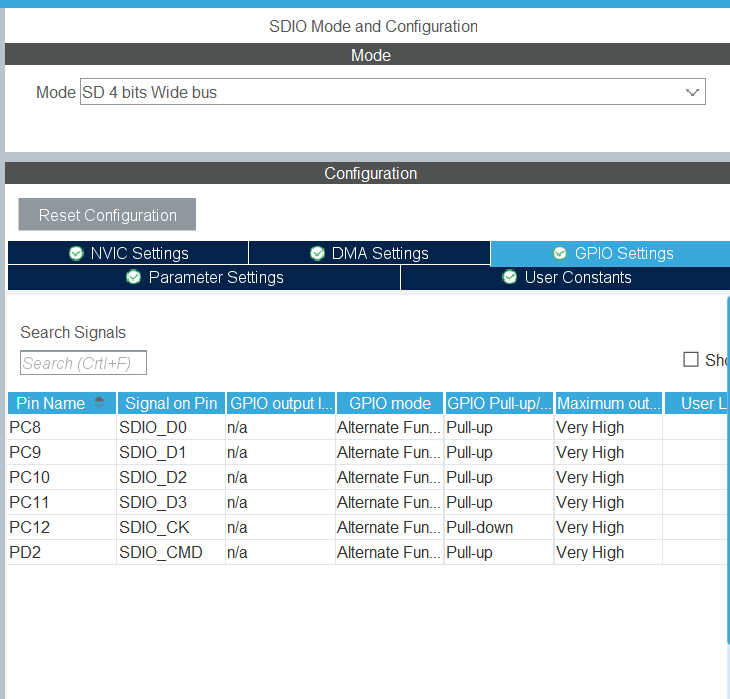

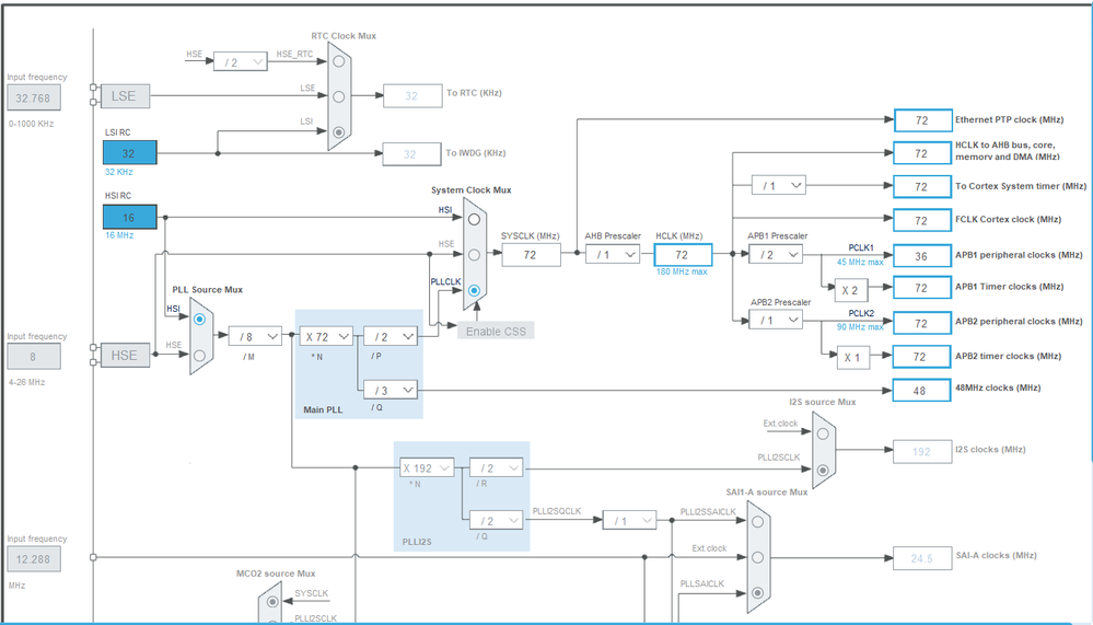

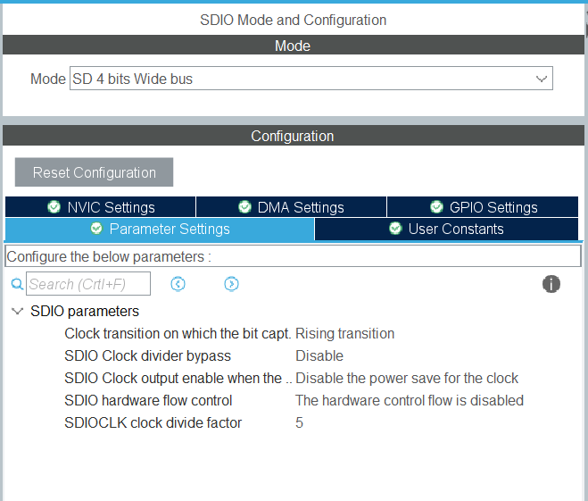

Hello, I've tried to test sdcard with fatfs on STM32F429ZI on NUCLEO-F429ZI board. The same code was working in SD 1 bit mode((no DMA, no RTOS).when i configure SD 4 bit mode f_mount returns FR_NOT_READY.

did you placed all the pullups?https://community.st.com/s/question/0D50X00009XkfrVSAR/using-internal-pullups-for-sdio-interface

I rechecked the wiring,it is okay.

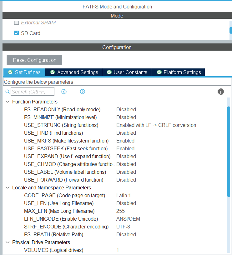

If any issue in my configuration,please check that

0693W00000SuDWdQAN.pngFatfs configuration:
the same code work if i generate sdio 1 bit mode with cubeMX .but in 4 bit mode it return FR_NOT_READY

4-BIT fussy to signal slewing, and correct mode selection at the card's command level.
Enable internally pull-ups on all lines except sdio _clk
what are the possibility if the 4 bit mode not working?
