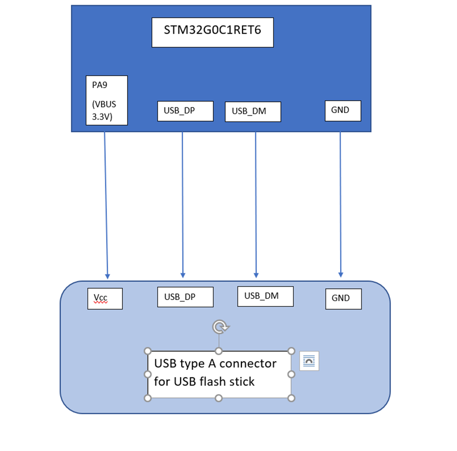

Here are details about my project:
My USB device is using FAT32 format. I AM SORRY if I made some dumb mistake; I am newbie

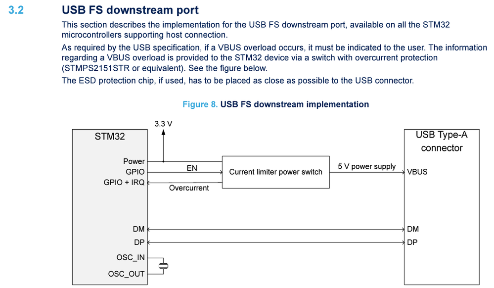

If your USB connection is as above, I recommend that you find the MX_DriverVbusFS function in the usbh_platform.c file and make its content compatible with your power switch IC.

Hiii, thank you so much for suggestion. Is it necessary to set USB connection as you showed in image??
I didn't make any connection like that. I just connected USB connector pin to STM32's A9 pin.

Do I need to use "current limiter switch" as shown in below diagram OR I can just directly connect STM32 pin with USB connector??
2022-05-12 08:30 AM
During the installation phase, the power of the usb disk needs to be cut and re-applied. It is necessary for safety to have current limitation, but you must use a switch
2022-05-12 08:41 AM
You can use STMPS2141 as switch. I also recommend adding a protection element such as USBLC6-2SC6 to the USB data line.
