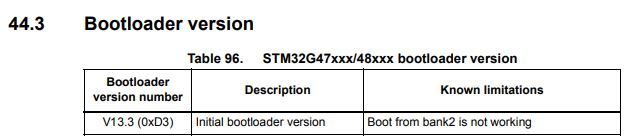

Are using the bootloader version v13.3 ? It seems there is a jumping problem between banks with the bootloader v13.3
As stating on the AN2606: the dual boot from bank 2 is not working on the bootloader V13.3
To be ensure that the bootloader version used is v13.3 please folow these steps:
- connect the board to STM32Cubeprogrammer
- read the address 0x1FFF6FFE
- the first bytes must have value 0xD3:
D ==> 13
3 ==> .3
For more details on how to identify the bootloader version - this is described in AN2606 application note - in chapter "4.2 Bootloader identification".

‎2021-04-21 7:47 AM
Thanks Imen!
The bootloader on the part I have is 13.4, so that part is OK.
Thank you for your suggestion of looking at the SYSCFG register...looking there helped me figure out what to do. When the BFB2 bit is set, and you boot from bank-2, the FB_MODE bit in the SYSCFG register gets set to '1'. I found this out by loading a simple application to bank-2 (loading to 0x0804 0000), setting BFB2 to '1', then booting the processor and using CubeProgrammer to connect in "Hot Plug" mode, and look at the SYSCFG register.
This picture, from AN4767 shows that when FB_MODE is set, the addresses are remapped:
So, with BFB2 set, and FB_MODE set, when I want to jump to the application that resides in Bank-1, I need to jump to the address: 0x0804 0000
Also, one thing I needed to do that I hadn't done before, was to alter the linker script for the application in Bank-1, and change the FLASH ORIGIN to 0x0804 0000, as opposed to 0x0800 0000. After building that, load the .bin to location 0x0800 0000, and jumping to application-1 in bank-1 worked!
