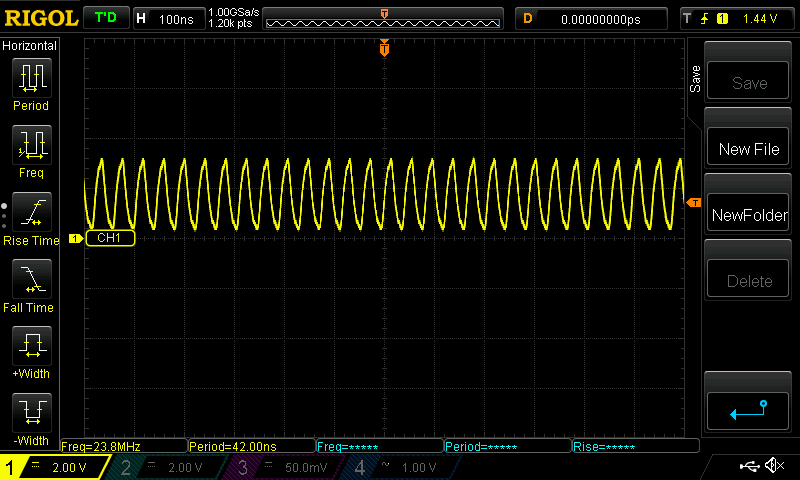

Hi to all,
After triple checked all (configuration and connection) I found the mistake.
The clock is too fast!
With oscilloscope on PC12 I see that the clock was not a square wave:

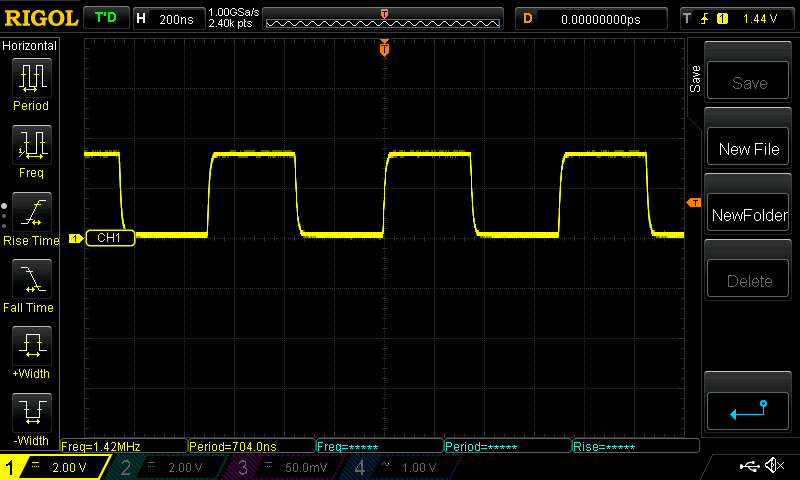

0693W000008yePSQAY.pngSo I changed "SDIOCLK clock divide factor" in CubeMX from 0 to 32. Now the clock is ok:
0693W000008yeQ1QAI.pngand the file was successfully written into SD card.
this limitation on clock is due to the NUCLEO-board or my SD CARD/slot ?
I have a 10k pullup resistor on MISO, MOSI and SCK, but as I can see from the wave form is not a pull-up issue.
