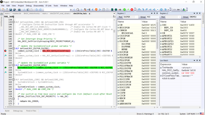

I am currently working on a project using the STM32H747I-Discovery Kit and have encountered an issue during system initialization. After integrating code from the STemWin_HelloWorld example and successfully compiling, the HAL_Init() function returns HAL_ERROR.
Upon debugging, I have found that the common_system_clock variable is being set to zero when returning from the following block of code:
#if defined(RCC_D1CFGR_D1CPRE)
  common_system_clock = HAL_RCC_GetSysClockFreq() >> ((D1CorePrescTable[(RCC->D1CFGR & RCC_D1CFGR_D1CPRE)>> RCC_D1CFGR_D1CPRE_Pos]) & 0x1FU);
#else
  // Other conditionals or relevant code
#endif
HAL_RCC_GetSysClockFreq() correctly returns a value that corresponds to 64MHz, so the issue seems to arise during the prescaler application. This leads to a situation where common_system_clock becomes zero, which should not be the case.
I have double-checked the clock configurations, prescaler settings, and the relevant RCC registers but have not found any discrepancies that could lead to this issue.
Could you please advise on what might be causing this behavior or provide any additional steps to troubleshoot this problem? I am using the latest HAL library version recommended for STM32H747I-Discovery.
Thank you in advance for your support.
Das
@FBL @Tesla DeLorean,
Issue identified and fixed. Thank you for the suggestions and support. Issue was in the linker script. Accidentally I changed the .rodata assigned to RAM.

RCC->D1CFGR contains What?
What about DBGMCU->IDCODE ?
I suspect D1CorePrescTable isn't deep enough
I noticed a weird thing, with my application in debug mode, I can't see the register values instead it shows(Debug Current Instruction Pointer). But I could see the current value of  D1CorePrescTable.
	Details:"Þ\0 `ßßP\032\thI\aúúúú"
	Default:0x24000020 <D1CorePrescTable>
	Decimal:603979808
	Hex:0x24000020
	Binary:100100000000000000000000100000
	Octal:04400000040

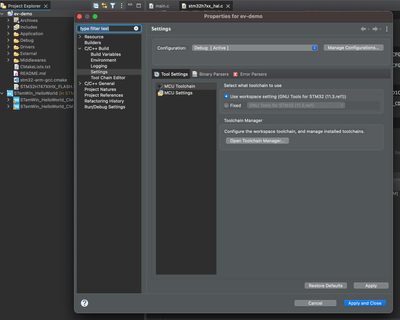

IDE : STM32CubeIDE
Toolchain: GNU Tools for STM32(11.3.rel1)
Hello_World Project Tool SettingsHello_World Project Tool Settings
My Project Tool SettingsMy Project Tool Settings
As I mentioned earlier, the project is not created in a standard way as I wanted to make my project as cmake based.  I had a feeling that because of that only Tool settings looks different. Is that creates this issue? Is there any way I can make a proper cmake project in STM32CubeIDE. I understood that if I enable Makefile generation as selected in STM32CubeIDE projects(make based), it enables additional options. I don't know whether that has something to do with my issue. Please take a look at my project structure and guide me to run some simple example in cmake way.
