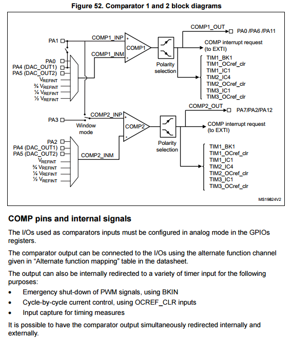

I am using the built-in comparator on a STM32F072RB. The comparator works fine, but now I want to be able to measure the amplitude of the sine-wave (already withing 0-3.3V limits) by 'removing' the pin from the comparator and 'giving' it to the ADC Channel 1 that it also able to operate from that same pin.
How do I De-Initialize the pin from the comparator (COMP1_INP) and allocate it to the ADC_IN1? My sine-wave is on pin PA1.

I guess the best way to know is to try it out, to get a quick answer, using a debugger.
Not used comparator so far... In the Ref Man:
So the pin is in analog mode with an analog mux depending on the chosen alternate function.
ADC, as long as the pin is in analog input, the ADC is already connected to the same signal.
It seems you should be able to use ADC without de-init the COMP. Just remember that an ADC conversion might make a ripple on the line which should be ignored by the comparator (application dependent).
