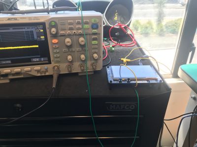

So, I have FDCAN working in internal and external loop back but when I connect it to an external CAN bus and switch it to standard operation I get nothing. I know there are messages on the CAN bus because I have a CAN scanner on the bus that is showing activity. However, the RX interrupt never goes off. My first debugging step was to remove the H7 from the bus and just see using an oscilloscope if the H7 was outputting anything (for loop with HAL_FDCAN_AddMessageToTxFifoQ and a 50ms delay) , I'm aware that two devices are needed for communication but from my understanding the FDCAN controller should still transmit until it reaches the ACK?
I then plugged in my CAN to USB converter connected directly to the H750B Discovery, I had a look at the signals before and after connecting the H750B and there was no change in the packets, they were the same if there was the single device (the CAN to USB converter) or if there was two devices, both the H7 and the CAN to USB converter. So it seams to me that the H7 is not ACKing or receiving the packet sent by the CAN to USB converter at all. This also seams to answer my previous question about what happens when there is only a singe device on the CAN bus, through I would not be surprised if my converter is doing something strange.

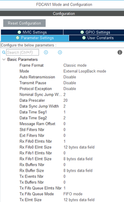

FDCAN (Classic Frame Format) Relevant Code and Calculations:

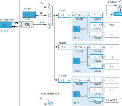

  1. CubeMX:

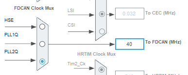

  2. Bit timings calculated using: https://kvaser.com/support/calculators/can-fd-bit-timing-calculator/?v=0.12&nbr=500000&dbr=500000&nsjw=11&dtps1=40&dtps2=39&f=40000&t=5000&d=180&np=1&dp=1Michael_GetElectronic_3-1733961318059.png

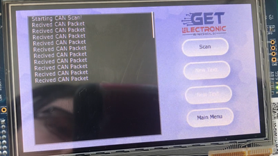

	sprintf(termnialBuffer.string, "Recived CAN Packet\n");
	xQueueSendFromISR(CANTerminalTextQueueHandle,&termnialBuffer,0);

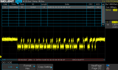

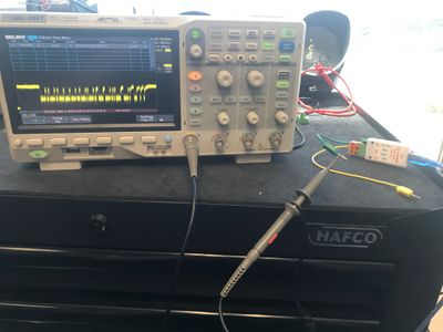

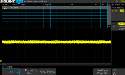

Test 1 Reading CAN form USB to CAN tool using oscilloscope:
First test was to get an idea of what I would expect to see when a single node is transmitting and to make sure I had my oscilloscope set correctly. Watching CAN LOW.

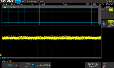

Set up using the CubeMX above, I press a button on the GUI to start the transmit and then prints a message to GUI when a CAN frame is received. Works as Excepted, except noting is seen on scope. From my understanding of external mode RX still transmits out of the controller so should be visible on scope, it just won't receive any external messages? That's the first sign of the problem. By this point I'm leaning towards I've somehow damaged the transceiver, but It's got ESD protection so I'm not sure.

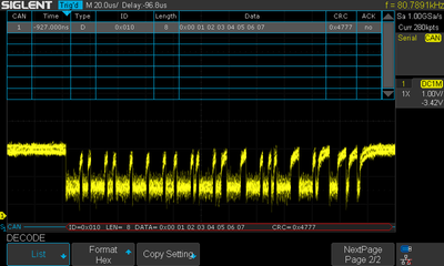

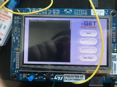

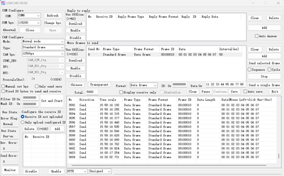

Test 3 CAN TO USB connected to H750B:
This time I connected the MCU to the USB to CAN tool with the hopes of seeing the messages from the CAN Controller only modification is changing the mode to normal in MX. Termination was enabled on both sides. I first started the CAN on the H7 with the CAN tool not sending anything. Nothing was received on the H7 as expected but it also did not transmit anything.
I then started Transmitting from the CAN tool. There were lots more frames I did not recognize this time but none of them were ACKed nor did the H7 receive anything.

For External Loopback probe directly on Tx pin not on the CAN_H and CAN_L.
