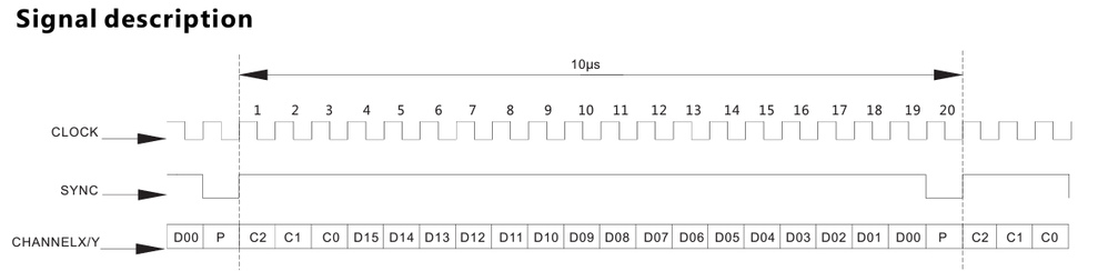

We want to develop a protocol called XY2-100. Here's a description of the protocol:
https://dvd.ilphotonics.com/Ray-Motion%20-%20galvanometers%20-%201D-2D-3D%20scanners/Motion%20Control%20-%20Optomechanics/Interface%20XY2-100.pdf
The protocol consists of four signals: Clock, ChannelX, ChannelY, Sync.
  • The data of each axis consist of 20-bit words.The first 3 bits are used as a control word(C2-C0).The next 16 bits are data information(D15-D0, offset binary) and the last bit is a parity bit(P, even parity).
  • The clock signal runs at a frequency of 2 MHz.When it goes high,the data bit changes.When it goes low,the data bit is sampled by the deflection system.
  • The transfer of data is synchronised using a synchronisation signal.The SYNC bit goes high when the first bit can be sent. It remains high for 19 bits and goes low when the parity can be sent.

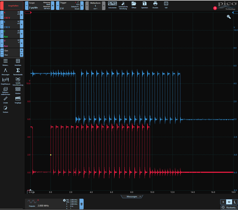

Initially, I successfully generated the clock of 2MHz with the following function:
void startScannerClk(void){
	 TIM3->CCR3 = 27;
	 HAL_TIM_PWM_Start(&htim3, TIM_CHANNEL_3);
Then, I attempted to try this function:
void send_Scanner_CHX(void){
	HAL_TIM_PWM_Start_DMA(&htim3, TIM_CHANNEL_3,(uint32_t *)chx_buf, 32);
	HAL_TIM_PWM_Start_DMA(&htim3, TIM_CHANNEL_4,(uint32_t *)chy_buf, 32);
The chx_buf and chy_buf contain the same data and are initialized like this:
#define DMA_Scanner_BUFFER_SIZE 50
uint16_t chx_buf[DMA_Scanner_BUFFER_SIZE];
uint16_t chy_buf[DMA_Scanner_BUFFER_SIZE];
I observed these signals:: red TIM_CHANNEL_3; blue TIM_CHANNEL_4
The clock of 20 periods, which is what is stored in chx_buf, works perfectly and the channel_4 generates the same signals but it starts around 2ns later, which would be a problem.

  1. Is it possible to generate the XY2-100 protocol with timers, PWM_DMA, and synchronization as described in the definition?CObri1_0-1708965451543.png
