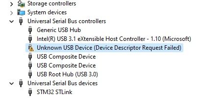

I struggled already two days with the implementation of USB_OTG_FS on a STM32F401 board. The most prominent error concerns the Virtual Com Port on the Windows PC: whatever I try, there is always a message saying "USB device not recognized", with as addition "Device Descriptor request failed".
In a final attempt I stepped my debugger through the initialization process and encountered the function 'USB_DevConnect(...)', located in the file: "ProjectName>>Drivers>>STM32F4xx_HAL_Driver>>Src>>stm32f4xx_ll_usb.c", line 76. I considered the statements in that function a bit strange, until my eye fell on the function 'USB_DevDisconnect(...)' right below the former one. The body of both functions are exact copies of each other!

Hallo Eddie,
I just have tried to get a project running on a STM32F401RCT6 board that just should output the values of an uint16_t array by USB_OTG_FS , configured as VCP device. I started the built-in 'serial wire' debugger and stepped through all relevant statements of the main function 'MX_USB_DEVICE_Init()'. When I arrived inside the function 'USB_DevConnect(...)', the execution of the second statement (USBx_DEVICE->DCTL &= ~USB_OTG_DCTL_SDIS;) caused the windows popup "USB device not recognized".
In the Windows Device Manager I identified the related USB device, see:DeviceManager_USBerror_.jpg
As this project only contains the USB_OTG_FS and a small piece of code that produces the data-array to be exported I am stuck. The application seems to run in the main 'while(1)' as designed, except the fact the function 'CDC_Transmit_FS(....)' doesn't do anything because the OTG status is 'HAL_BUSY'.

When I try to understand what the function 'Get_SerialNum' will assign to 'deviceserial0' and 'deviceserial1',
I conclude it will be undefined, depending on the old values on the addresses of these variables.
As I mentioned before, I have no idea of the consequences for a successful USB connection, but I think it is useful to report such CUBEIDE compiler-warnings.

PR1G0RYAN
I banged into same issue with with my F103 after update to Cube IDE 1.15. Seems like autogeneration sucks.
This is what I got:
static void Get_SerialNum(void)
  uint32_t deviceserial0;
  uint32_t deviceserial1;
  uint32_t deviceserial2;
  deviceserial0 += deviceserial2;
  if (deviceserial0 != 0)
    IntToUnicode(deviceserial0, &USBD_StringSerial[2], 8);
    IntToUnicode(deviceserial1, &USBD_StringSerial[18], 4);
And here's how IT SHOULD BE:
  deviceserial0 = *(uint32_t *) DEVICE_ID1; // Missing
  deviceserial1 = *(uint32_t *) DEVICE_ID2; // Missing
  deviceserial2 = *(uint32_t *) DEVICE_ID3; // Missing
