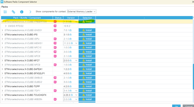

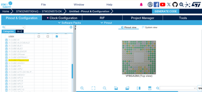

Hello everyone,
I’m currently working with the STM32N6570-DK board and would like to run a program using FreeRTOS. I’m having some trouble finding clear guidelines or examples specific to this board.
My questions are as follows:
  • Has anyone successfully run FreeRTOS on the STM32N6570-DK? If so, could you share the steps or point me to any documentation/tutorials?
  • Are there any plans to integrate FreeRTOS support into the MX Cube environment for this board?
Any help, tips, or insights would be greatly appreciated.
Thanks in advance for your support!

Hello @Konstantina
You can use X-Cube FreeRTOS in CubeMX.
Please refer to examples below to get started with X-cube FreeRTOS on N6 series:
x-cube-freertos/Projects/NUCLEO-N657X0-Q/Applications at main · STMicroelectronics/x-cube-freertos · GitHub
